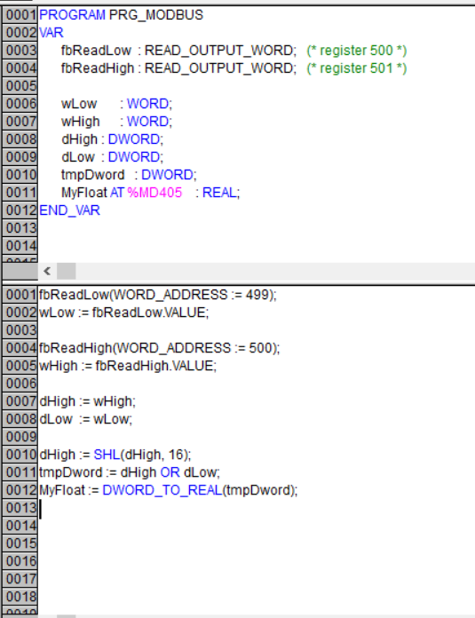

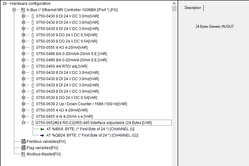

&lt;p&gt;It's my first time operating in Codesys 2.3, but I have done a good amount of Codesys programming, so I'm a little familiar. I haven't done a lot of RTU, but a lot of Modbus TCP.&lt;/p&gt;
&lt;p&gt;I don't have the PLC in my reach at the moment, but I'm trying to be a little ahead. &lt;br/&gt;
We're adding the 750-652 module to read energy from a flowmeter over RTU. There will only be 1 slave.&lt;/p&gt;
&lt;p&gt;I attached pictures of my current hardware, PLC code and the register datasheet.&lt;/p&gt;
&lt;p&gt;I'm uncertain if this will work.&lt;br/&gt;
Any help or clarification on how things work will be greatly appreciated.&lt;/p&gt;
&lt;p&gt;Thanks in advance.&lt;/p&gt;&lt;/div&gt;</summary></entry></feed>
