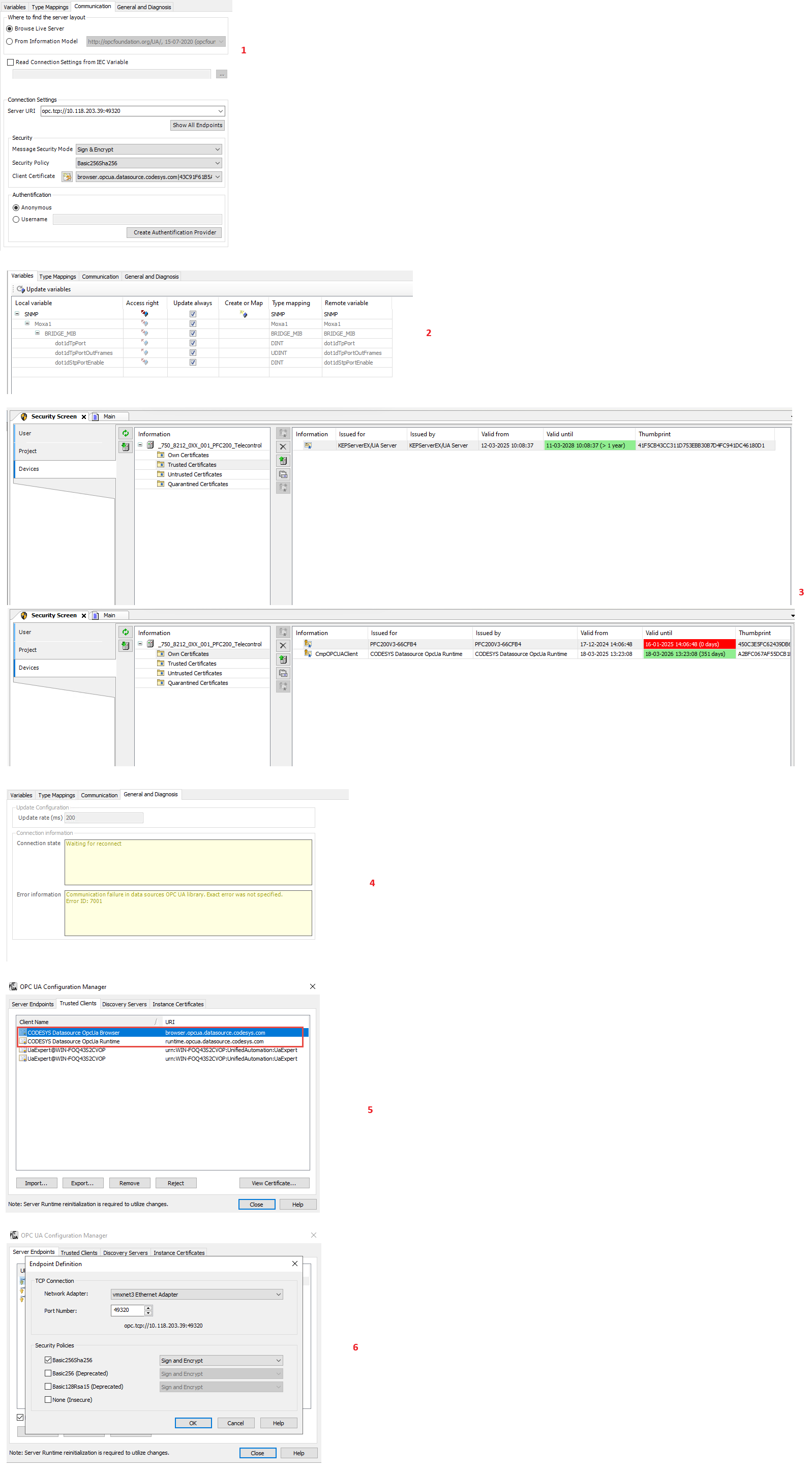

I have problem with connecting Wago PLC WAGO 750-8212/0025-0002 configured as OPC UA client to Kepware OPC UA Server. I am using Codesys 3.5.19.70.&lt;/p&gt;
&lt;p&gt;What I did so far.&lt;br/&gt;
To the Codesys project I added object Data Source Manager and configured connection OPC UA like below:&lt;br/&gt;
&lt;strong&gt;pic 1&lt;/strong&gt;&lt;/p&gt;
&lt;p&gt;Then I can browse the OPC server tags in “Variables” tab after prior trust on the server side of the client certificate created in the “Communication” tab:&lt;br/&gt;
&lt;strong&gt;pic 2&lt;/strong&gt;&lt;/p&gt;
&lt;p&gt;Additionally second certificate has been created in Codesys for runtime process in “Security screen” as well as the server certificate was approved here:&lt;br/&gt;
&lt;strong&gt;pic 3&lt;/strong&gt;&lt;/p&gt;
&lt;p&gt;But when I compiled project, downloaded it to PLC and go to RUN I can’t read selected in “Variables” tab, OPC Server tags. I am getting such error (ID: 7001):&lt;br/&gt;
&lt;strong&gt;pic 4&lt;/strong&gt;&lt;/p&gt;
&lt;p&gt;All two PLC certificates has been trusted in OPC server (Kepware) side:&lt;br/&gt;
&lt;strong&gt;pic 5&lt;/strong&gt;&lt;br/&gt;
and&lt;br/&gt;
Kepware server configuration look like this:&lt;br/&gt;
&lt;strong&gt;pic 6&lt;/strong&gt;&lt;/p&gt;
&lt;p&gt;I can easily connect using third party OPC UA client UaExpert to Kepware server without problem.&lt;br/&gt;
In attachment I added also log from Kepware OPC UA server.&lt;br/&gt;
&lt;em&gt;pic # - this specifies the number of a concrete graphic from one of the collective in attachment&lt;/em&gt;&lt;/p&gt;&lt;/div&gt;</summary></entry></feed>
