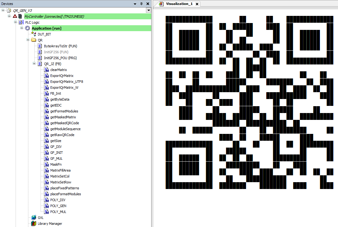

<feed xml:lang="en" xmlns="http://www.w3.org/2005/Atom"><title>Recent posts to Special Chars in Visualizationfor QR code string</title><link href="https://forge.codesys.com/forge/talk/Engineering/thread/33479618b2/" rel="alternate"/><link href="https://forge.codesys.com/forge/talk/Engineering/thread/33479618b2/feed.atom" rel="self"/><id>https://forge.codesys.com/forge/talk/Engineering/thread/33479618b2/</id><updated>2025-10-04T01:58:12.427000Z</updated><subtitle>Recent posts to Special Chars in Visualizationfor QR code string</subtitle><entry><title>Special Chars in Visualizationfor QR code string</title><link href="https://forge.codesys.com/forge/talk/Engineering/thread/33479618b2/?limit=25#b8bd" rel="alternate"/><published>2025-10-04T01:58:12.427000Z</published><updated>2025-10-04T01:58:12.427000Z</updated><author><name>jzhvymetal77</name><uri>https://forge.codesys.com/u/jzhvymetal77/</uri></author><id>https://forge.codesys.comc815adfdb3d36d4e1ea24249b945c5fa54d8cca2</id><summary type="html">&lt;div class="markdown_content"&gt;&lt;p&gt;Ok, I got UTF-8 encoding working by encoding the full block character using &lt;span&gt;[16#E2, 16#96, 16#88]&lt;/span&gt;, which corresponds to U+2588 "█". Moving forward, I’ll use this for creating a QR code with Version 10-M (byte mode). This version allows up to 213 characters to be encoded.  &lt;/p&gt;&lt;/div&gt;</summary></entry><entry><title>Special Chars in Visualizationfor QR code string</title><link href="https://forge.codesys.com/forge/talk/Engineering/thread/33479618b2/?limit=25#9188" rel="alternate"/><published>2025-09-29T14:53:24.247000Z</published><updated>2025-09-29T14:53:24.247000Z</updated><author><name>jzhvymetal77</name><uri>https://forge.codesys.com/u/jzhvymetal77/</uri></author><id>https://forge.codesys.com43d4f61adefdfa8566c163ee376defdc56c1a21f</id><summary type="html">&lt;div class="markdown_content"&gt;&lt;p&gt;Ok I closer as I switch using WSTRING but in Visualization it does not respect LINE BREAKS.  Instead it shows $n.  See attached image.&lt;/p&gt;&lt;/div&gt;</summary></entry><entry><title>Special Chars in Visualizationfor QR code string</title><link href="https://forge.codesys.com/forge/talk/Engineering/thread/33479618b2/?limit=25#31ee" rel="alternate"/><published>2025-09-29T13:24:32.988000Z</published><updated>2025-09-29T13:24:32.988000Z</updated><author><name>jzhvymetal77</name><uri>https://forge.codesys.com/u/jzhvymetal77/</uri></author><id>https://forge.codesys.com64853b1fabd50216c6cdca996d298a6b4b059cde</id><summary type="html">&lt;div class="markdown_content"&gt;&lt;p&gt;In Visualization, is there any way to make special characters in a string display properly in a Text object? I wrote a function block to create QR codes at runtime. My code uses “$DB,” which in ASCII should render as a solid block. The code works, but to display it in Visualization I had to create multiple rectangles with visibility bound to a BOOL array. That works, but since each BOOL must be exposed as a separate variable, it consumes most of the available monitoring resources. See Attached image.&lt;/p&gt;&lt;/div&gt;</summary></entry></feed>
