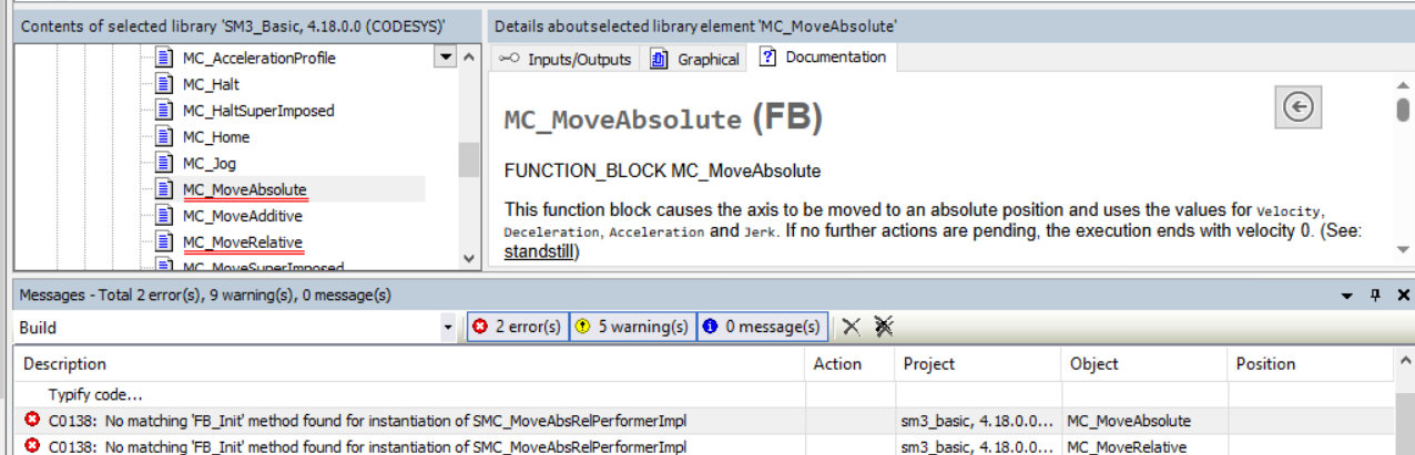

Thank you for your reply.&lt;/p&gt;
&lt;p&gt;The exact version of Codesys and its compiler was 3.5.21.20.&lt;br/&gt;
The compiler version was fixed and could not be changed in project settings.&lt;/p&gt;
&lt;p&gt;Since I couldn't continue due to this compilation error, I temporarily overcame this issue as follows.&lt;br/&gt;
-- I completely uninstalled Codesys 3.5.21.20 and completely deleted the Codesys folder in the C:\ProgramData folder.&lt;br/&gt;
-- I restarted my computer and installed Codesys 3.5.19.70.&lt;br/&gt;
-- I updated the Codesys Installer and all its add-ons to the latest versions.&lt;br/&gt;
-- The project that was giving me the compilation error I mentioned before is now open with Codesys 3.5.19.70, compiled it, and successfully downloaded it on the device.&lt;br/&gt;
-- I haven't encountered the same problem anymore. I think this issue is related to SP21 and its compiler.&lt;/p&gt;
&lt;p&gt;Frankly, I'd expect a project created with an older version to compile without errors after opening it with the latest Codesys version and updating all libraries.&lt;/p&gt;
&lt;p&gt;Regards,&lt;br/&gt;
imdatatas&lt;/p&gt;&lt;/div&gt;</summary></entry><entry><title>MC_MoveAbsolute: C0138:  No matching 'FB_Init' method found for instantiation of SMC_MoveAbsRelPerformerImpl [ERROR]</title><link href="https://forge.codesys.com/forge/talk/Motion/thread/9074005bf4/?limit=25#9e3a" rel="alternate"/><published>2025-09-08T14:54:02.328000Z</published><updated>2025-09-08T14:54:02.328000Z</updated><author><name>gseidel</name><uri>https://forge.codesys.com/u/gseidel/</uri></author><id>https://forge.codesys.com582fcb382835c56c8e0daebd0233bfaf78f1bc70</id><summary type="html">&lt;div class="markdown_content"&gt;&lt;p&gt;Hi Imdat,&lt;/p&gt;

&lt;p&gt;Updating and converting an existing working Codesys Softmotion axis control project to the latest Codesys IDE and Softmotion version always gives the following error message during compilation.&lt;/p&gt;
&lt;p&gt;"&lt;br/&gt;
&lt;span&gt;[ERROR]&lt;/span&gt; sm3_basic, 4.18.0.0 (codesys): MC_MoveAbsolute: C0138: No matching 'FB_Init' method found for instantiation of SMC_MoveAbsRelPerformerImpl&lt;br/&gt;
"&lt;br/&gt;
-- Previously working version:&lt;br/&gt;
Codesys IDE SP18.50, Softmotion 4.10.0.0&lt;/p&gt;
&lt;p&gt;-- Later updated version with the error:&lt;br/&gt;
Codesys IDE SP21.10, Softmotion 4.18.0.0&lt;/p&gt;
&lt;p&gt;Has anyone encountered a similar issue?&lt;br/&gt;
How can this be resolved?&lt;/p&gt;
