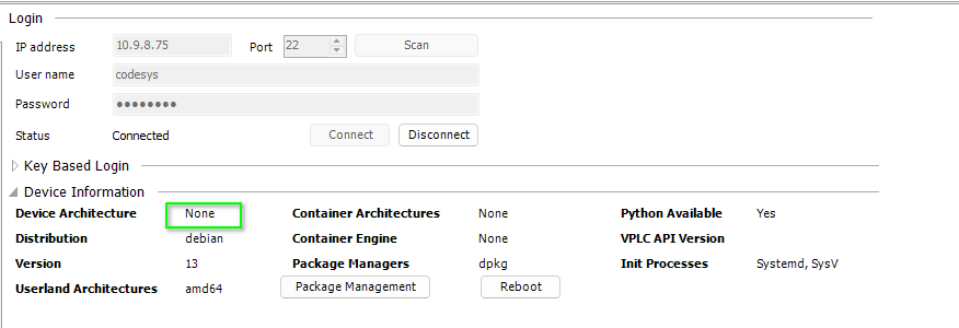

&lt;a href="https://content.helpme-codesys.com/en/CODESYS%20Control/_rtsl_toubleshooting_deploytool2.html#UUID-b83dc01e-8cff-c574-7efe-8615b95a51ed_section-idm234790234401598" rel="nofollow"&gt;https://content.helpme-codesys.com/en/CODESYS%20Control/_rtsl_toubleshooting_deploytool2.html#UUID-b83dc01e-8cff-c574-7efe-8615b95a51ed_section-idm234790234401598&lt;/a&gt;&lt;/p&gt;&lt;/div&gt;</summary></entry><entry><title>Unable to deploy "Control for Linux SL 4.18.0.0"</title><link href="https://forge.codesys.com/forge/talk/Runtime/thread/5374a0df34/?limit=25#8399" rel="alternate"/><published>2026-02-18T08:37:47.083000Z</published><updated>2026-02-18T08:37:47.083000Z</updated><author><name>pernockham</name><uri>https://forge.codesys.com/u/pernockham/</uri></author><id>https://forge.codesys.com4f4bd2c48377a85e5aad1a8911e4a8c5ba95cb26</id><summary type="html">&lt;div class="markdown_content"&gt;&lt;p&gt;Correct, my Device architecture says "None" is this position. A missing config somewhere? &lt;/p&gt;&lt;/div&gt;</summary></entry><entry><title>Unable to deploy "Control for Linux SL 4.18.0.0"</title><link href="https://forge.codesys.com/forge/talk/Runtime/thread/5374a0df34/?limit=25#d34a" rel="alternate"/><published>2026-02-17T17:52:34.254000Z</published><updated>2026-02-17T17:52:34.254000Z</updated><author><name>eschwellinger</name><uri>https://forge.codesys.com/u/eschwellinger/</uri></author><id>https://forge.codesys.combc0882a73fc3058e4e2c93750be0e1f84c4ce6b4</id><summary type="html">&lt;div class="markdown_content"&gt;&lt;p&gt;Hi&lt;br/&gt;

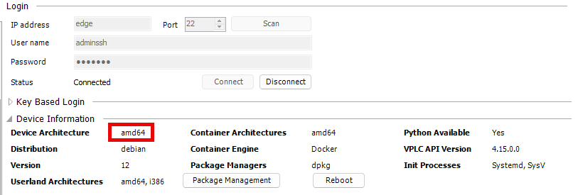

could you check if this really exists in 4.19.0.0 deploy tool?&lt;br/&gt;

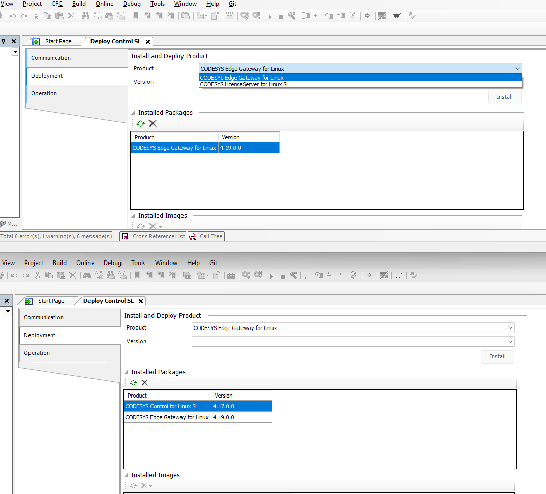

In your case architecture is missing- see my configuration&lt;/p&gt;&lt;/div&gt;</summary></entry><entry><title>Unable to deploy "Control for Linux SL 4.18.0.0"</title><link href="https://forge.codesys.com/forge/talk/Runtime/thread/5374a0df34/?limit=25#f3bd" rel="alternate"/><published>2026-02-17T15:18:46.406000Z</published><updated>2026-02-17T15:18:46.406000Z</updated><author><name>pernockham</name><uri>https://forge.codesys.com/u/pernockham/</uri></author><id>https://forge.codesys.coma6cde2ef145d64a53634b5b396d63f7f65b08dc2</id><summary type="html">&lt;div class="markdown_content"&gt;&lt;p&gt;And the strange thing for me is that if i connect with an older IDE version (where I only have 4.17.0.0 installed) I can see both "CODESYS Control for Linux SL" and "CODESYS Edge Gateway for linux". &lt;/p&gt;
&lt;p&gt;And that I loose (both presence and possibility to update) the first option (Control SL) if i let the updater install "Control for linux SL" vers. 4.18.0.0 or later.&lt;/p&gt;
&lt;p&gt;Attached print screen where I connected the "deploy sl tool" to the same system, where the upper one has 4.19.0.0 installed, while the lower one has 4.17.0.0 installed.. &lt;/p&gt;&lt;/div&gt;</summary></entry><entry><title>Unable to deploy "Control for Linux SL 4.18.0.0"</title><link href="https://forge.codesys.com/forge/talk/Runtime/thread/5374a0df34/?limit=25#9f40" rel="alternate"/><published>2026-02-17T11:19:21.387000Z</published><updated>2026-02-17T11:19:21.387000Z</updated><author><name>pernockham</name><uri>https://forge.codesys.com/u/pernockham/</uri></author><id>https://forge.codesys.comc992cb145a90ccae531e07d558ebe091a6c9f8b1</id><summary type="html">&lt;div class="markdown_content"&gt;&lt;p&gt;Does this cover what you need?&lt;/p&gt;&lt;/div&gt;</summary></entry><entry><title>Unable to deploy "Control for Linux SL 4.18.0.0"</title><link href="https://forge.codesys.com/forge/talk/Runtime/thread/5374a0df34/?limit=25#b742" rel="alternate"/><published>2026-02-17T11:00:12.685000Z</published><updated>2026-02-17T11:00:12.685000Z</updated><author><name>eschwellinger</name><uri>https://forge.codesys.com/u/eschwellinger/</uri></author><id>https://forge.codesys.com764f9775738f6b24cbbd6d74d35cacda41886e97</id><summary type="html">&lt;div class="markdown_content"&gt;&lt;p&gt;we need the Systeminformation in the Communication tap(logged in)&lt;/p&gt;&lt;/div&gt;</summary></entry><entry><title>Unable to deploy "Control for Linux SL 4.18.0.0"</title><link href="https://forge.codesys.com/forge/talk/Runtime/thread/5374a0df34/?limit=25#5278" rel="alternate"/><published>2026-02-17T08:27:15.149000Z</published><updated>2026-02-17T08:27:15.149000Z</updated><author><name>pernockham</name><uri>https://forge.codesys.com/u/pernockham/</uri></author><id>https://forge.codesys.com5cf95eaf6d15b5bdb8be118872b8f2023243792e</id><summary type="html">&lt;div class="markdown_content"&gt;&lt;p&gt;Am I alone in this? &lt;/p&gt;

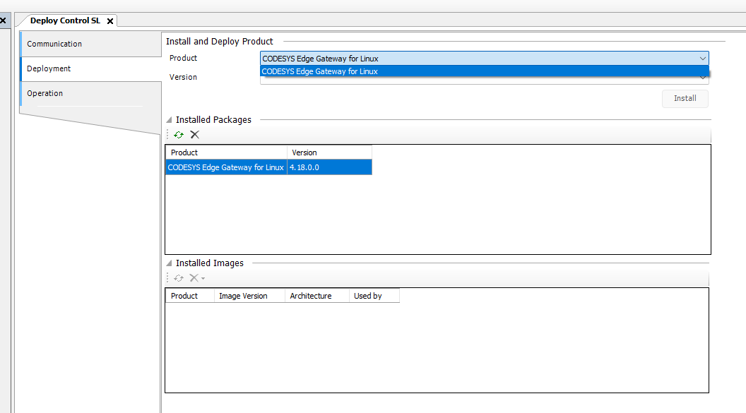

&lt;p&gt;Is this a known fault? Should I look for the reason of the lacking update option for "Control for linux SL" in my system or is it a potential fault in the codesys system? &lt;/p&gt;&lt;/div&gt;</summary></entry><entry><title>Unable to deploy "Control for Linux SL 4.18.0.0"</title><link href="https://forge.codesys.com/forge/talk/Runtime/thread/5374a0df34/?limit=25#888d" rel="alternate"/><published>2026-02-16T11:30:18.037000Z</published><updated>2026-02-16T11:30:18.037000Z</updated><author><name>pernockham</name><uri>https://forge.codesys.com/u/pernockham/</uri></author><id>https://forge.codesys.coma52354b62ca86ede92d9ef39081565436836c27b</id><summary type="html">&lt;div class="markdown_content"&gt;&lt;p&gt;Downloaded and installed edge gateway 4.19.0.0. Unfortunately same behavior: "Control for Linux SL" NOT shown in drop lists on either "Deployment" Tab of tool "Deploy Control SL", or as "installed packages" on "Operation" tab (only "CODESYS Edge Gateway for linux" is shown).&lt;/p&gt;&lt;/div&gt;</summary></entry></feed>
