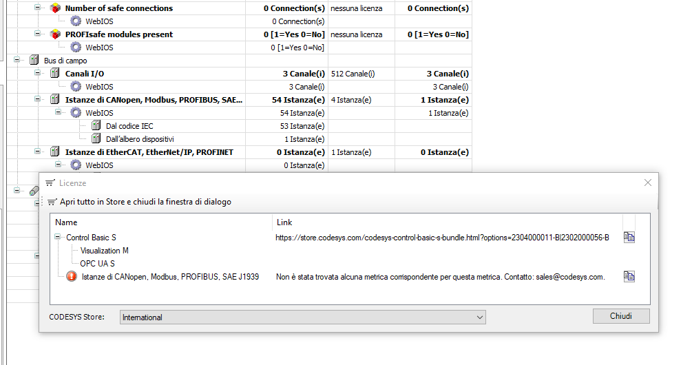

Using version 3.5.21.xx, it is no longer possible to use Modbus function blocks (I make extensive use of these FBs.)as shown in the example.&lt;br/&gt;
&lt;a href="https://content.helpme-codesys.com/en/CODESYS%20Examples/_ex_modbus_example.html" rel="nofollow"&gt;https://content.helpme-codesys.com/en/CODESYS%20Examples/_ex_modbus_example.html&lt;/a&gt;&lt;/p&gt;
&lt;p&gt;The compiler detects one Modbus instance for each instance of the communication FB block. The example program above, although simple, reports 8 Modbus instances when compiled with the latest version.&lt;/p&gt;
&lt;p&gt;Codesys Support says that you must use fieldbus I/O mapping, but this will result in the loss of the ability to programmatically modify communication parameters.&lt;/p&gt;
&lt;p&gt;Sandro&lt;/p&gt;&lt;/div&gt;</summary></entry><entry><title>Application-based license Modbus Channels</title><link href="https://forge.codesys.com/forge/talk/Runtime/thread/99305761f1/?limit=25#57cf" rel="alternate"/><published>2025-09-01T14:18:35.526000Z</published><updated>2025-09-01T14:18:35.526000Z</updated><author><name>gatto</name><uri>https://forge.codesys.com/u/gatto/</uri></author><id>https://forge.codesys.com641f7bbd39b59390f30a068264a9c4bd6172cf9a</id><summary type="html">&lt;div class="markdown_content"&gt;&lt;p&gt;Hi Sandro, did you find any solution?&lt;br/&gt;
I'm in version 3.5.20.40 and i have only one modbus channel.&lt;br/&gt;
I don't want the problem to happen to me if I do an update one day.&lt;/p&gt;&lt;/div&gt;</summary></entry><entry><title>Application-based license Modbus Channels</title><link href="https://forge.codesys.com/forge/talk/Runtime/thread/99305761f1/?limit=25#575b" rel="alternate"/><published>2025-08-27T15:04:24.617000Z</published><updated>2025-08-27T15:04:24.617000Z</updated><author><name>sandro66</name><uri>https://forge.codesys.com/u/sandro66/</uri></author><id>https://forge.codesys.comd54ce3908e100516e6fcbdfc4d9a90f702d1ca66</id><summary type="html">&lt;div class="markdown_content"&gt;&lt;p&gt;Hi,&lt;br/&gt;
I imported an old project created with version 3.51.20.50 into the new version 3.51.21.20. I'm using ModbusFB.ClientTCP v4.5.0.0. Strangely, I can no longer download the project due to a licensing issue I didn't have before. The number of Modbus channels has gone from 1 to 54!, and there's no license that would work.&lt;br/&gt;
Can anyone tell me where I'm going wrong?&lt;/p&gt;
&lt;p&gt;Thanks&lt;br/&gt;
Sandro&lt;/p&gt;&lt;/div&gt;</summary></entry></feed>
