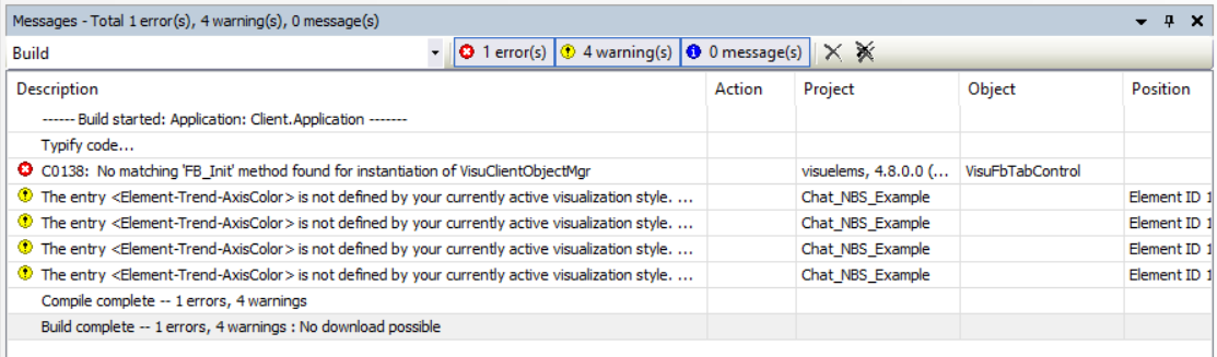

&lt;p&gt;you can try to disable "Visualization Manager - Settings - Support client animations and overlay of native elements " selection"&lt;/p&gt;
&lt;/blockquote&gt;
&lt;p&gt;It worked for me, thank you.&lt;/p&gt;&lt;/div&gt;</summary></entry><entry><title>C0138: No matching 'FB_Init' method found for instantiation of VisuClientObjectMgr</title><link href="https://forge.codesys.com/forge/talk/Visualization/thread/0763d6ca8e/?limit=25#6aec" rel="alternate"/><published>2025-10-10T08:20:45.348000Z</published><updated>2025-10-10T08:20:45.348000Z</updated><author><name>cihangur</name><uri>https://forge.codesys.com/u/cihangur/</uri></author><id>https://forge.codesys.com733e887808348427c81723e44849b43edffe39c7</id><summary type="html">&lt;div class="markdown_content"&gt;&lt;p&gt;This "FB_Init" error has become very annoying lately. It's usually related to webvisu and is resolved by deleting all objects and related libraries.&lt;/p&gt;

&lt;p&gt;I downloaded the "Example: PLC Chat Net Base Services" example from the Codesys help site to review and try it out.&lt;/p&gt;
&lt;p&gt;&lt;a href="https://content.helpme-codesys.com/en/CODESYS%20Examples/_ex_cds_plc_chat_net_base_services.html" rel="nofollow"&gt;https://content.helpme-codesys.com/en/CODESYS%20Examples/_ex_cds_plc_chat_net_base_services.html&lt;/a&gt;&lt;/p&gt;
&lt;p&gt;However, when I open and compile the example program with SP21 Patch2, I get the strange error message below regarding Visualisation component, and it fails to compile.&lt;/p&gt;
&lt;p&gt;"&lt;br/&gt;
&lt;span&gt;[ERROR]&lt;/span&gt; visuelems, 4.8.0.0 (system): VisuFbTabControl:&lt;br/&gt;
C0138: No matching 'FB_Init' method found for instantiation of VisuClientObjectMgr&lt;br/&gt;
"&lt;/p&gt;
&lt;p&gt;Are others experiencing the error "C0138: No matching 'FB_Init' method found for instantiation..." when trying to compile example projects created with older versions of Codesys with a later version of the IDE?&lt;/p&gt;
&lt;p&gt;How did you overcome this problem? &lt;br/&gt;
Could you share your solutions?&lt;/p&gt;
&lt;p&gt;Regards,&lt;br/&gt;
Imdat&lt;/p&gt;&lt;/div&gt;</summary></entry></feed>
