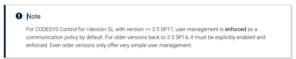

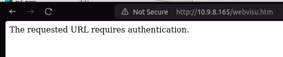

&lt;p&gt;"The requested URL requires authentication". &lt;/p&gt;
&lt;p&gt;Setting the device back to 4.14.0.0. the web page will respond. &lt;/p&gt;
&lt;p&gt;Access to web page through Automation server is possible also for the newer version, but not "local" access. &lt;/p&gt;
&lt;p&gt;Runtime (Codesys control for linux SL) is on 4.17.0.0.&lt;/p&gt;
&lt;p&gt;I have tried to manipulate settings for 'Access-Control-Allow-Origin' '*' always; through nginx (normally a proxy_pass to localhost:8080).&lt;/p&gt;
&lt;p&gt;Also tested bypassing nginx by accessing 8080 directly with the same result. &lt;/p&gt;&lt;/div&gt;</summary></entry></feed>
