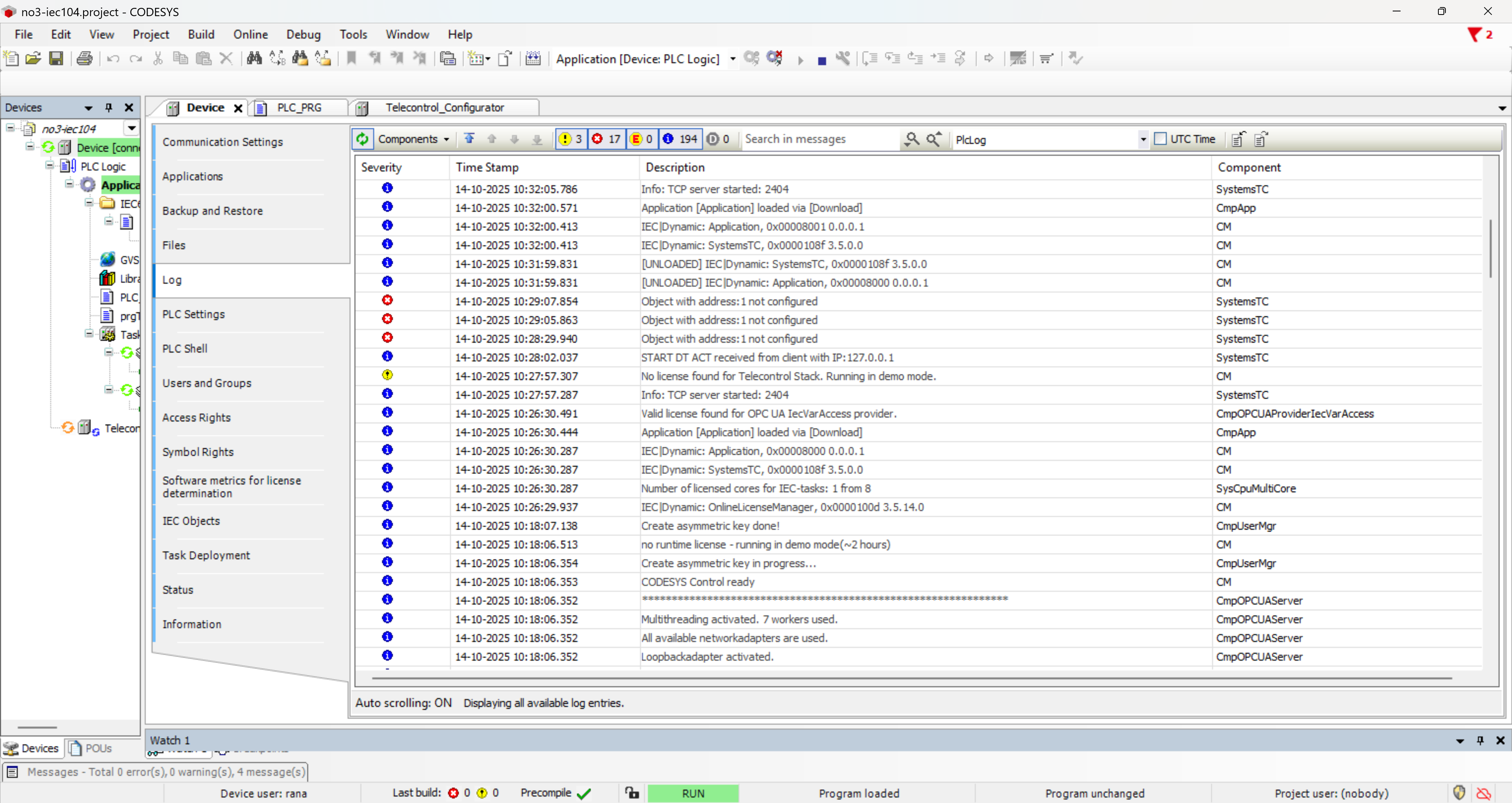

As we didn't have client for IEC - 104 - only server server is available , so because of that we are trying to make establish the communication between the external simulator as a Client and codesys itself as a server. We are looking for the variable behavior from CODESYS has to change according to the message triggered by the CLIENT (we are using simulator Application like Redisant).
We are able to see the log data as the status of triggering the SCS from Client received to the Log data of the codesys device(attached screen shot of it) and in simulator panel we had set the details to trigger the data from Redisant to Codesys.
Current Status: The project builds and runs successfully, but I need guidance on how to connect this to an external IEC-104 simulator for testing and visualization by using demo mode.
