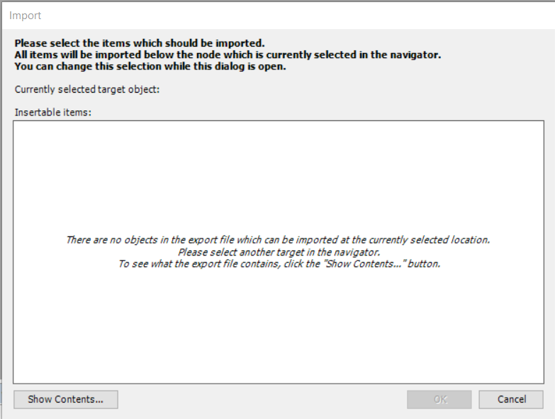

When I try to import some POUs that were previously exported from another project as an XML file, I get an error like in attached image and the process does not complete.
"There are no objects in the export file..."
I am using SP21 Codesys IDE and I do not know which version this XML (*.export) file was previously exported with.
It is not an error, but just an information message.
You need to select the correct location in your device tree where you want to import the objects.
E.g. select Application below your Device.
