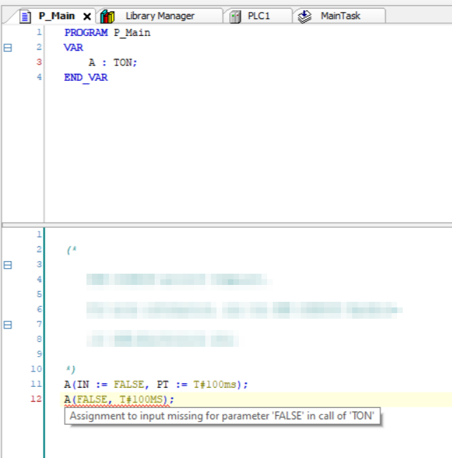

Is it possible to do non-formal invocation of function blocks in CODESYS?
I get an error when I try, see the attached pic. Also attached a pic from IEC 61131-3 describing non-formal invocations.
No that is not possible for function blocks, although it is possible to that with methods and functions as you see in your second pic.
