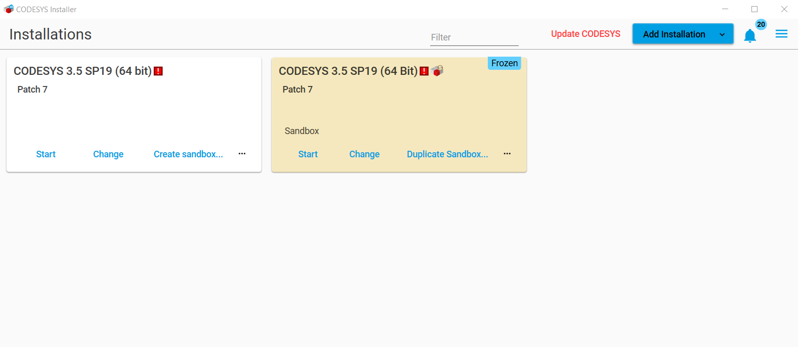

I created a new sandbox image on the D drive with Codesys Installer.

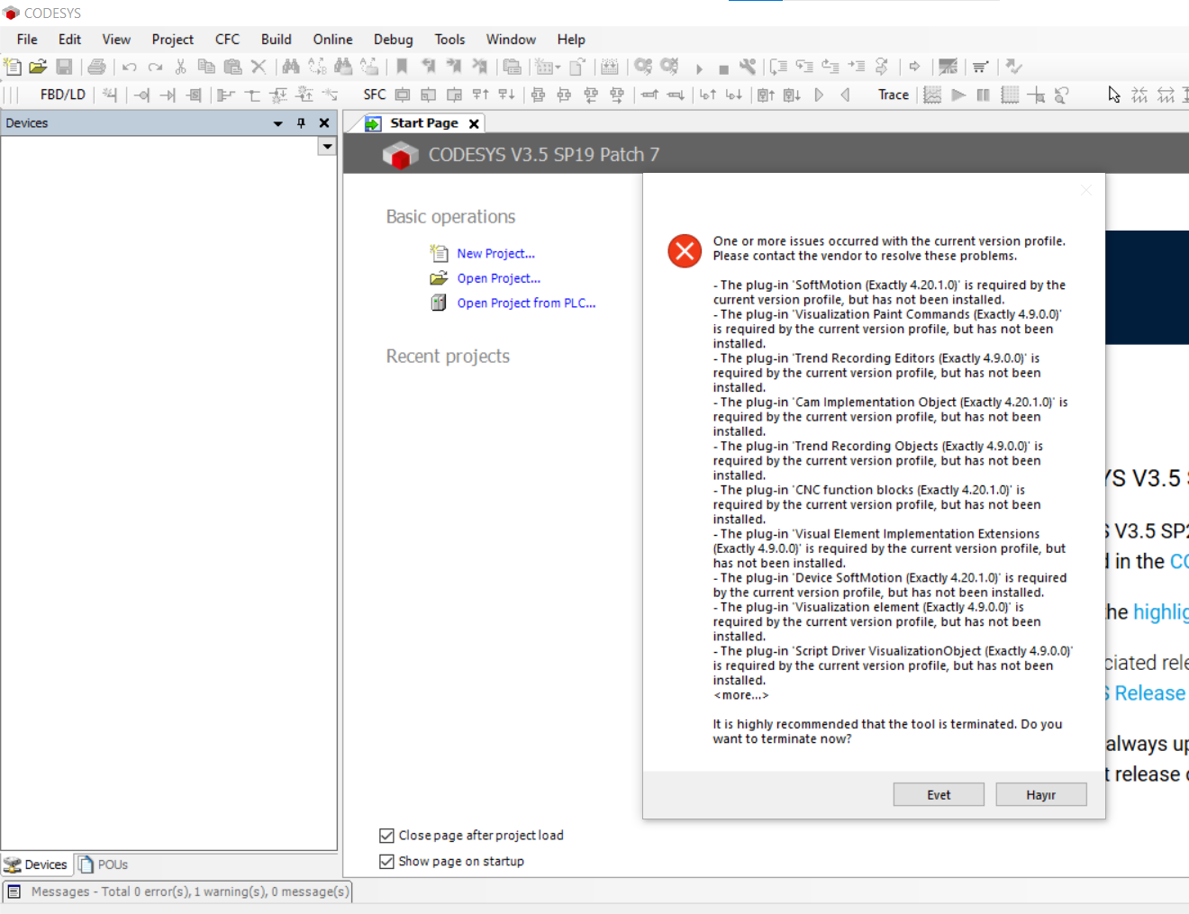

However, when I launch the IDE from this image, it gives the error shown in the attached image.
-- Codesys V3.5 SP19 Patch7.
-- The installer is the latest (2.5.0).
-- All packages in the installer were updated to the latest version as of today when creating the sandbox.
-- The originally installed IDE on the C drive does not give this error when launched.
-- I last upgraded it to Softmotion 4.20.1.0 through the installer.
Has anyone encountered the same or a similar issue?
Will this issue be fixed in the next update?
