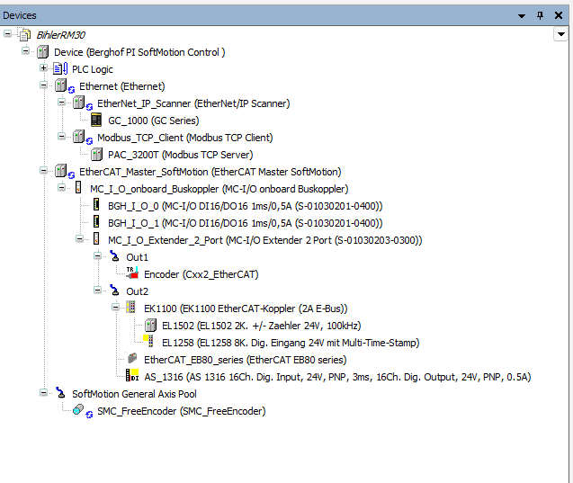

  • jonasz - 2025-07-15
    Hi,
    I'll link to the topic not wanting to start a new one.
    In the application I am building, I wanted to use the diagnostics described in the CAA Device Diagnosis library.
    In principle, everything is ok, except for the elements related to ModbusTCP.
    Despite the fact that ModbusTCP is taken into account in the documentation, it is not recognised via the interfaces.

    (* Diagnostyka Modbus.*)
        Modbus_TCP_Client.GetDeviceInfo(deiInfo := ModbusTcpClientDeviceInfo);
        ModbusTcpClientDeviceState := Modbus_TCP_Client.GetDeviceState();
        PAC_3200T.GetDeviceInfo(deiInfo := ModbusTcpDeviceInfo);
        ModbusTcpDeviceState := PAC_3200T.GetDeviceState();
    Of course, you can take the easy way out and refer directly to the devices, but I wanted a reusable component.
    Any constructive help is very welcome
    Best regards
    Jonasz
