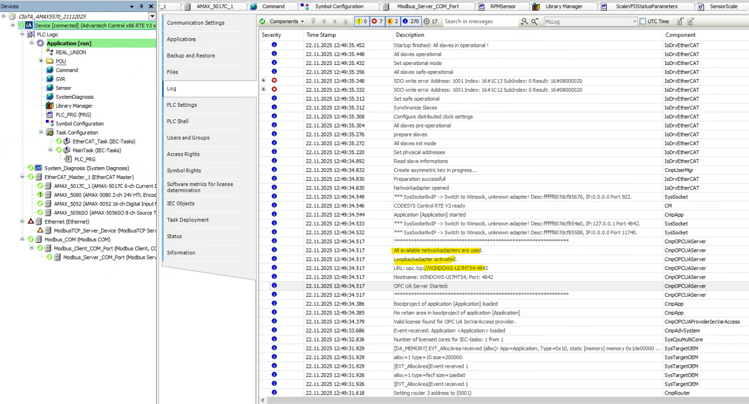

I am facing a persistent issue with the OPC UA Server on Advantech Soft PLC with hard realtime for Win64 (V3_5_2010_3) and need help from the community.
Device Information
Name: Advantech Control x86 RTE V3 x64
Vendor: Advantech Co., Ltd.
Categories: PLCs
Version: 3.5.20.10
Description: Advantech Soft PLC with hard realtime for Win64 (V3_5_2010_3)
Problem Summary
The OPC UA Server works perfectly when accessed via:
opc.tcp://localhost:4842
opc.tcp://<hostname>:4842</hostname>
But it does NOT work when using the LAN IP:
opc.tcp://192.168.0.XX:4842
In UAExpert I get:
Discovery FindServers on opc.tcp://192.168.0.XX:4842 failed (BadCommunicationError)
Port is LISTENING in windows Firewall.. Tried with turning off the firewall completely.

System Information
Windows 10 x64
Advantech CODESYS RTE Soft-PLC (hard real-time)
Network IP: 192.168.0.XX
Hostname: WINDOWS-XXXXX
Need your Support
