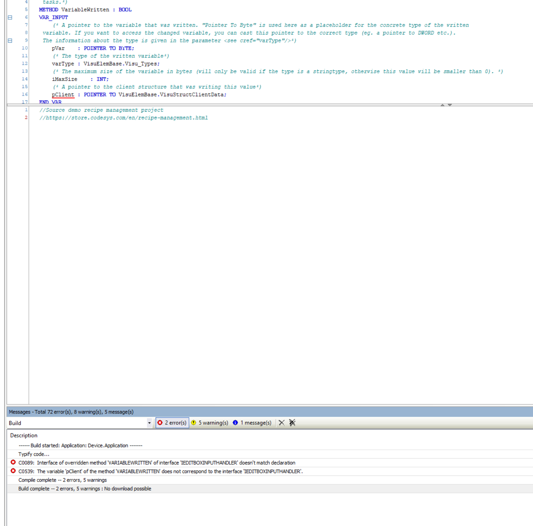

Im running into a problem after moving from SP18 to SP20 or SP21. After the update I have an error with the TextFieldInmputHandler.VariableWritten which is implemented if de visualisation part of my software. The interface seems to have changed. I cannot find the new implementation. Does anyone know how to solve this issue.

have you tried:
VisuElems.VisuStructClientData
