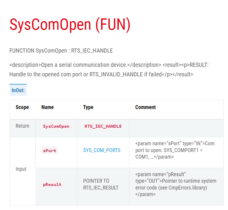

I am facing issues with using SysCom library. With SysCom23 library things were simple but since we are migrating to 64bit systems, I am writing a Porting program.
With SysCom23, opening the comport was as simple as providing the ComPort no. which returns the Handle as a DWORD.
dwHandle:=SysComOpen(Port);
But the new library is a bit different. It is asking for 2 input parameters to open the Com Port - Port Number and POINTER to RTS_IEC_RESULT

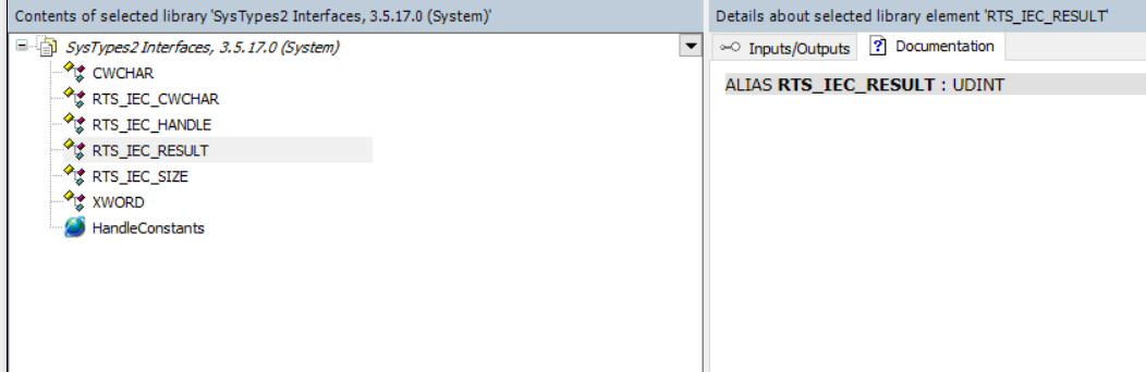

How should I use the RTS_IEC_Result? I can find RTS_IEC-REUSLT under SysType2Interfaces of SysCom library.
Also, can someone give me a general understanding of this RTS_IEC_REULT and RTS_IEC_HANDLE, etc.?
Link to library: https://content.helpme-codesys.com/en/libs/SysCom/Current/index.html
Update:
I was able to successfully use the SysCom.lib. I had to install SysTypes2Interface library as well and wrote following code.
Declaration
Implementation
