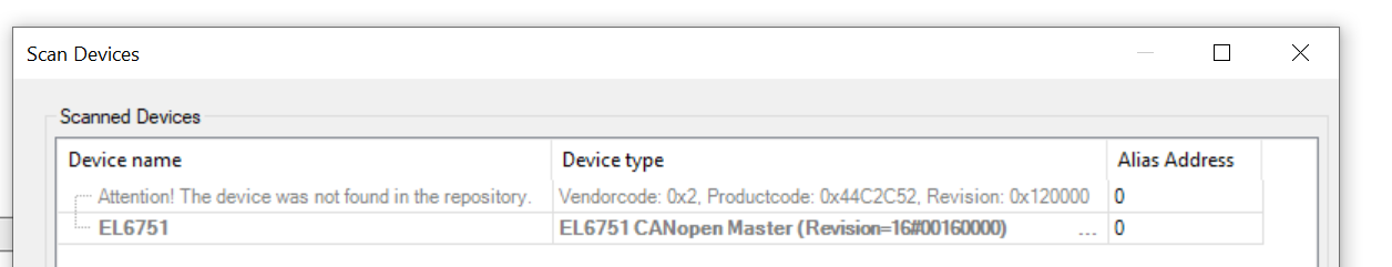

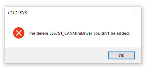

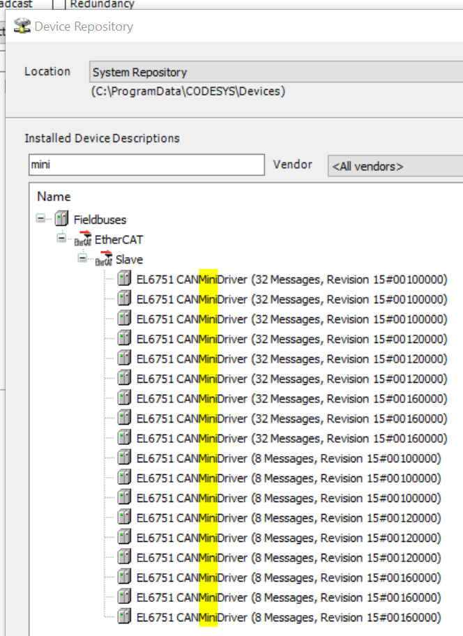

I have working EtherCAT since it can be scanned for slaves, but then I'm stuck getting the information that the device isn't found in the repo. As far as I can see both revisions does however exist in the device repo.

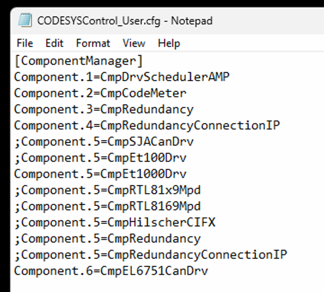

Component added in the Configfile.
Anyone with some similar experiences?
For reference, it was just me being unfamiliar with EtherCAT in CoDeSys. Anyone with knowledge who would have opened the ScanResult screenshot would have identified that the preceding EK1100 was the device missing in the library.
Bottom line - Do something else for a while and then get back at it with fresh eyes!
