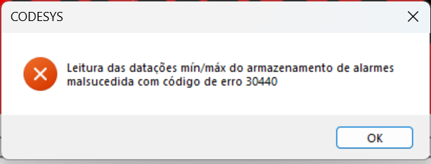

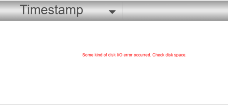

I am running tests using the Windows runtime environment.
The alarm history is not being logged and displays the error: "Some kind of disk I/O error occurred. Check disk space" in the alarm table. Furthermore, it is not possible to export the alarms.
I have already tried to find a configuration field in Alarm storage and Alarm configuration to fix this problem, but I haven't found any related fields.
It is most likely related to the existing alarm log files in the Control Win. Depending on how you start up the Control Win, you can find the files in:
C:\Users\<user name="">\AppData\Roaming\CODESYS\CODESYSControlWinV3x64\<unique id="">\PlcLogic\alarms\
Or
C:\Windows\System32\config\systemprofile\AppData\Roaming\CODESYS\CODESYSControlWinV3x64\<unique id="">\PlcLogic\alarms\</unique></unique></user>
Delete the files in this folder, download your project again and start the application.
PS, if you have an older version of CODESYS, the files are in:
C:\ProgramData\CODESYS\CODESYSControlWinV3x64\<unique id="">\PlcLogic\alarms</unique>
