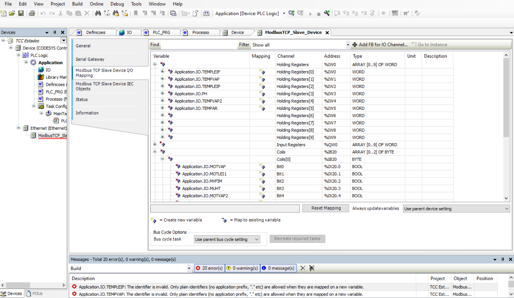

I'm using Modbus TCP/IP to communicate Codesys with Elipse E3 as the master for a college project.
I have made a list of global variables to organize the programming in two different POUs. The problem is, when I try to do the mapping of variables, the program informs me of an error due to the identifiers having a "." on their names. Do I have to reorganize my code to make it an unified block or is there a way to declare their names without changing all the code structure?
IN THE MAPPING COLUMN, TRY CLICKING THE ICON TO "MAP TO EXISTING VAR"
