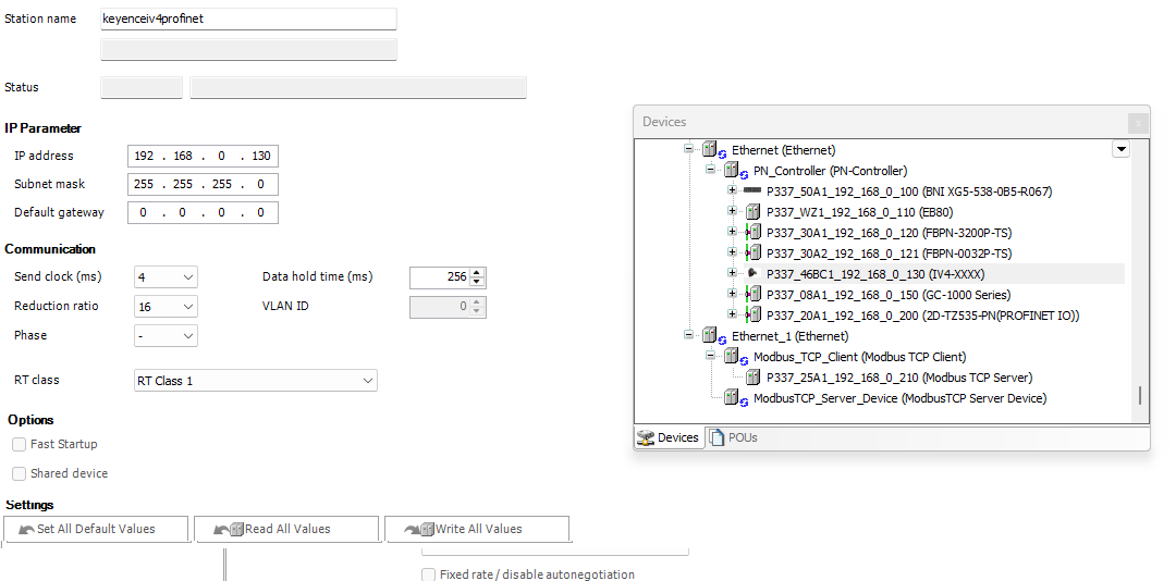

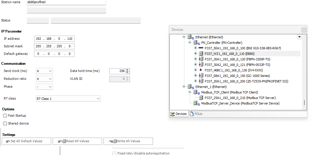

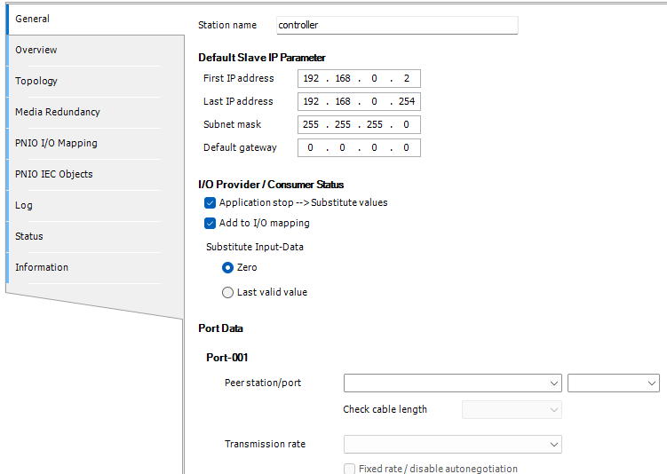

I am writing to You with the problem of Profinet communication in my Codesys V2.5 SP21 project working on Codesys Control RTE V3 x64 device.
I have implemented multiple Profinet devices in the network, the Profinet itself is configured properly, based on the hardware and software parameters of the industrial PC (Windows 10 IoT).

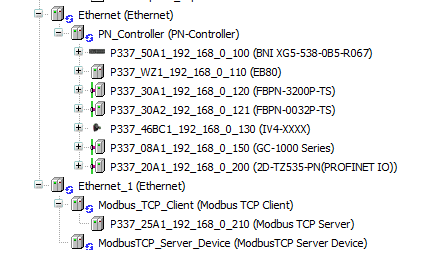

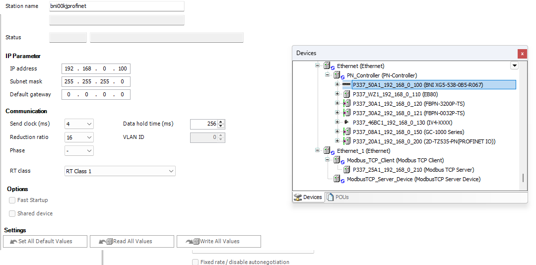

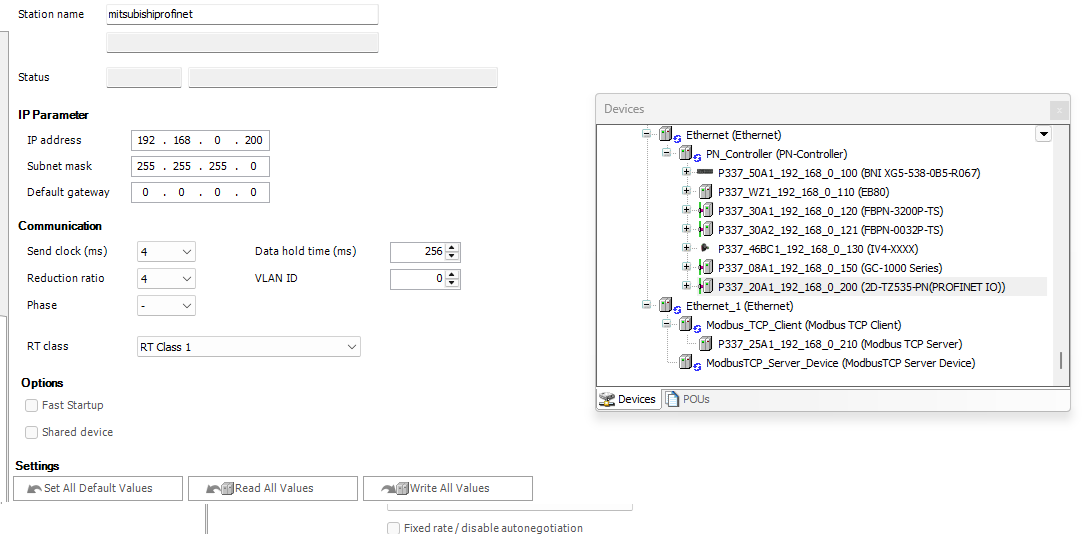

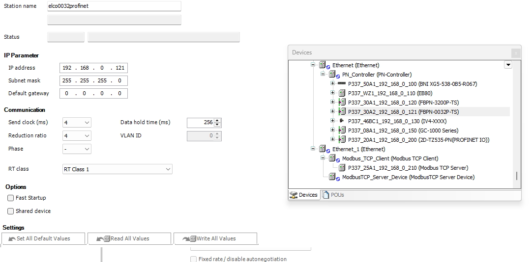

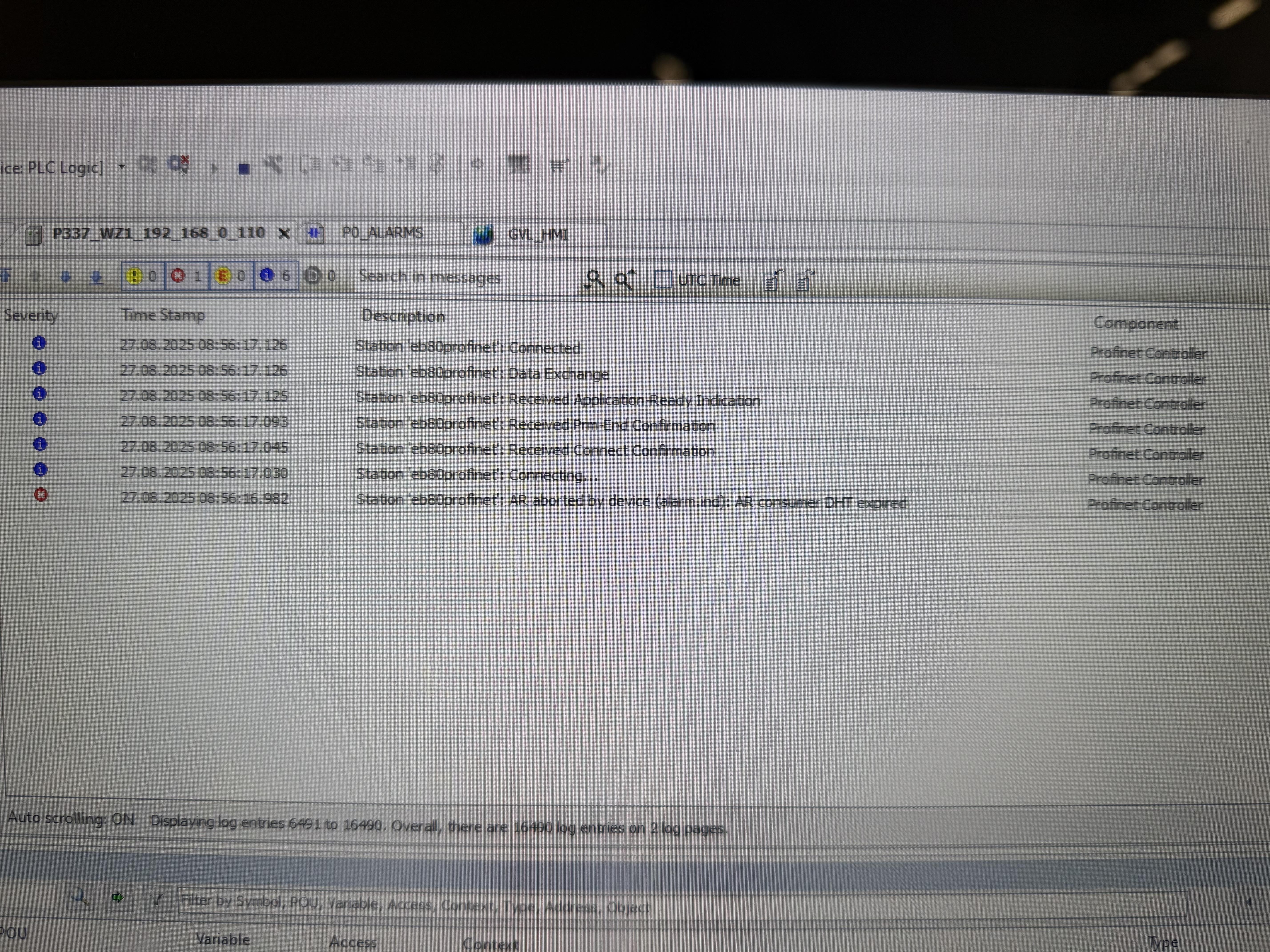

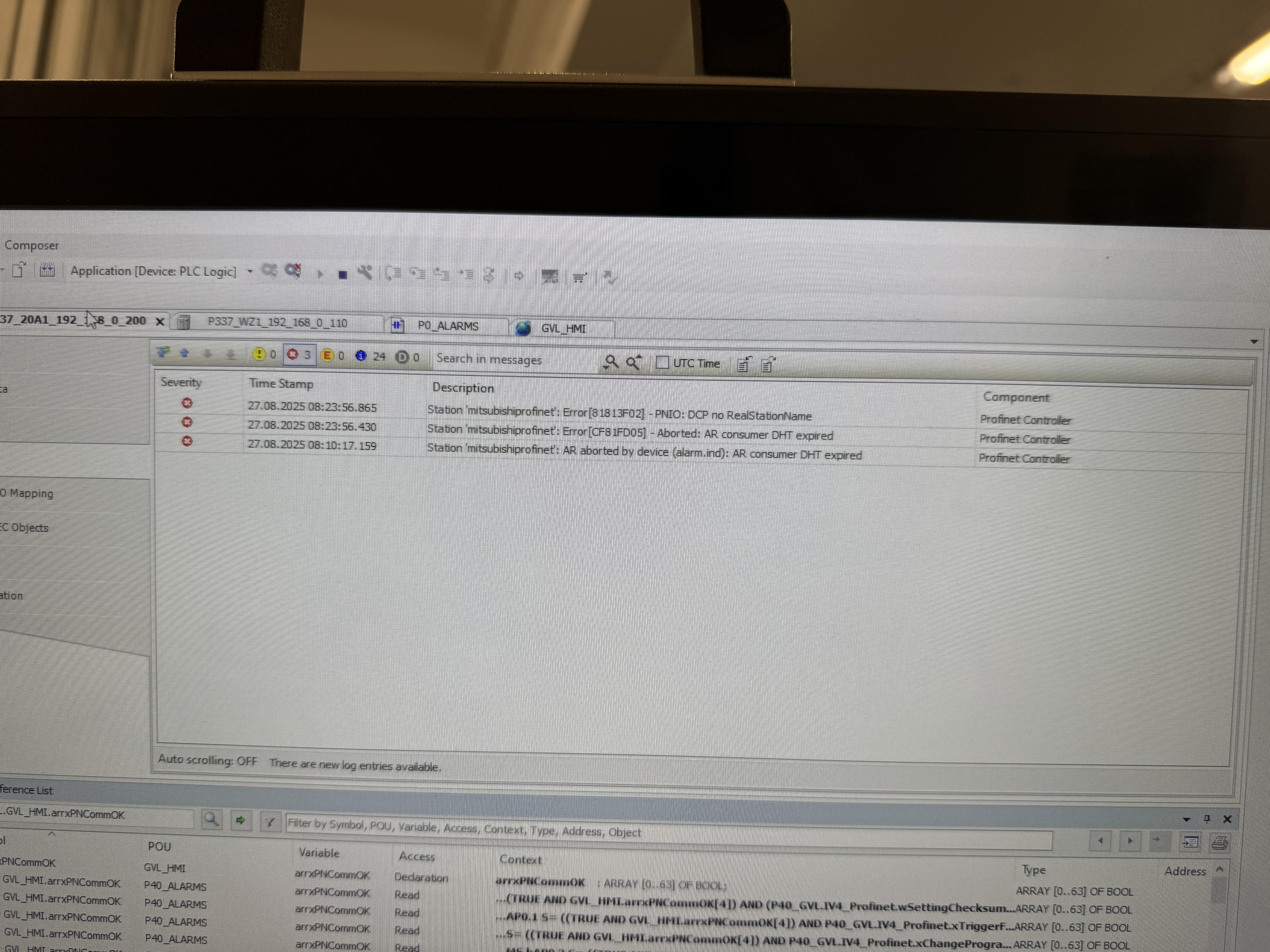

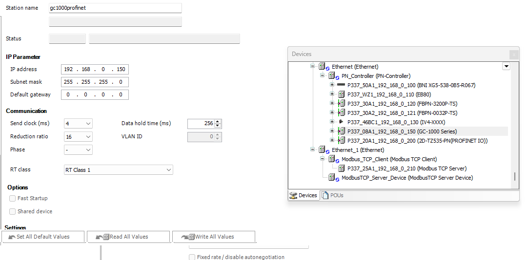

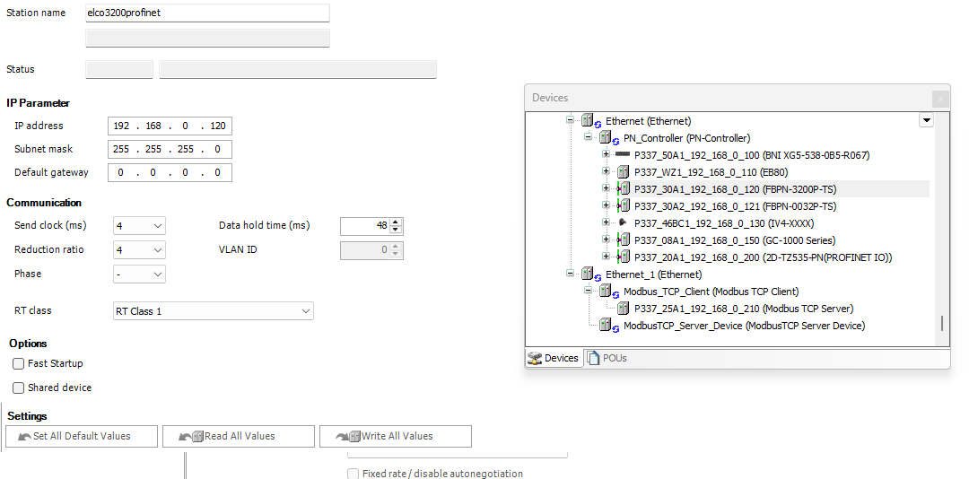

My Profinet network contains such Profinet devices as a robot, IO-Link master with some devices on it, IO modules, safety, vision sensor (the configuration is attached to this topic). Once every few hours, sometimes more often, sometimes not even once a day, the error show up at one, two or a few random modules at the same time, every one is the same: "Station 'xyz': AR aborted by device (alarm.ind): AR consumer DHT expired". The communication is then lost with that module, but it is up instantly. It is not such a problem when it comes to regular IOs, but with safety or rotation table, it causes errors and machine stops.

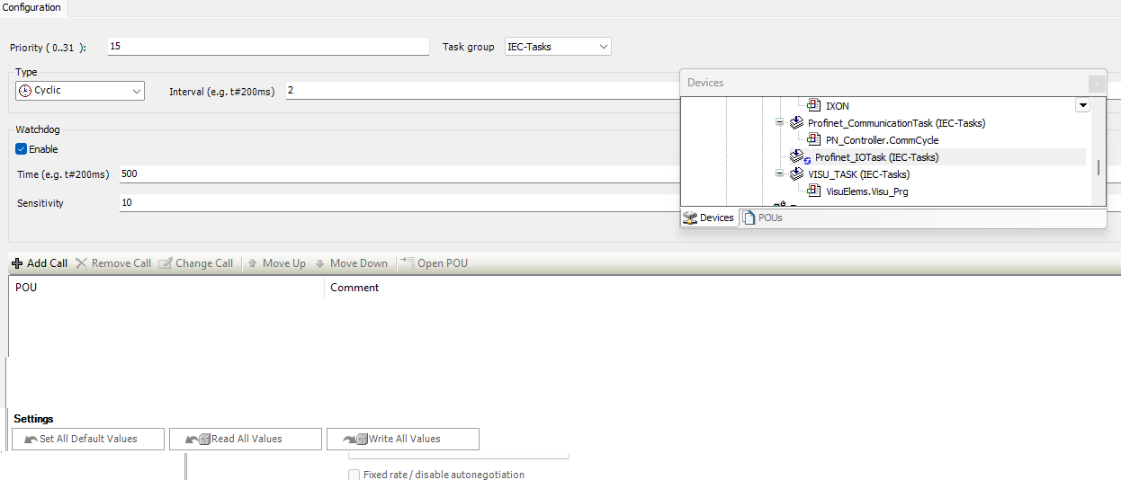

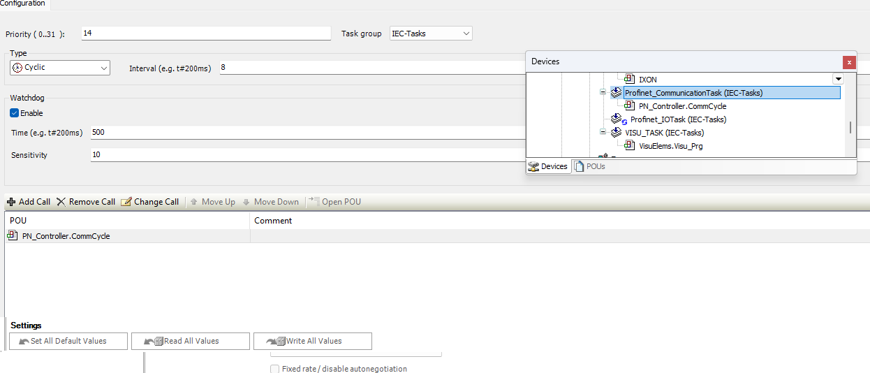

I have tried multiple solution based on any forum suggestions, manuals, etc., but it is still happening. Mabye when I turned on the Watchdog for this communication, it is happening less times, but still, I could not turning up the Watchdog parameters at the expense of cycle time of the process. The same is with Send Clock, Reduction and DHT.

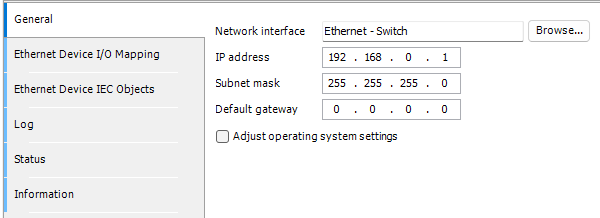

I have one of the ethernet port on the PC configured with CmpEt1000Drv driver. The card itself is Intel Ethernet Connection I219-LM. These devices are connected to one EKI-2728-NI-A Profinet switch (it was changed from the standard non Profinet one, but still nothing has changed).
As I said ealier, I am attaching all the configurations for each device and the communication itself - if any of You had the same problems or have any ideas what could be the cause, I would be much gratefull for any help. For now I am out of ideas, if You have any additional question, please ask.
