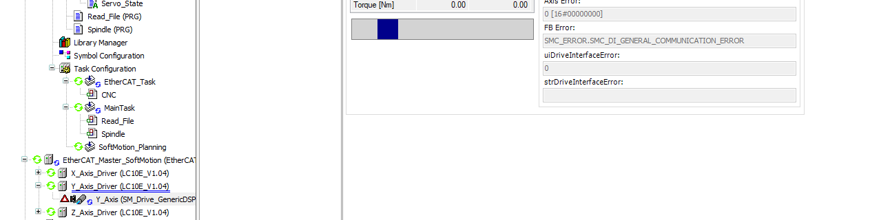

Just new to motion and i am building my own 3axis cnc cutter using servo drives.
i have every thing working quite well apart from mc_home.
when executed (r_trig) it stops immediately and i get fb_wasnt_called_during_motion.
if i execute the mc_home fb with a toggle it just runs and runs for a while then errors out.
what im unsure of is the way mc_home works.
from what i understand it changes the drive mode to 6 (homing) and should then run of the drive homing settings.
once origin sensor is made then homing would stop and mc_home.done is true. and the position on the fb is where i what the new home position (zero) to be? or do i feed mc_readposition to that input?
so i would think its the settings in the drive that aren't quite right. but i believe they are all correct.
has any one got any info to steer me in the right direction?
Cheers

also get this error in place of the other from time to time.
