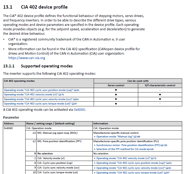

basically the i950 drive support CiA402 Basic and CiA402 Advanced modes. I attached pictures of both mode supported functions. It also support CSP, VL, CSV and CST modes.
It seems the homing mode is in CiA402 Advanced mode but how can you not have the homing mode in both modes? It is a vital part of any servo system.
If I use the SoftMotion standard demo mode, I can move the servo absolute and relative but cannot home it.
But in SoftMotion Light mode, I cannot execute any motion function.

I don't have time to go through the whole manual but as I said earlier, the servo drive does not support any of the modes needed for SoftMotion Light to work.
If you want to use the full SoftMotion, you could use SMC_Homing function block to do the homing. This function block does not use the Homing Mode. It still uses the CSP mode and does the logic in Codesys runtime instead of in the servo drive. Read the documentation about it to see if it fits your needs.
But if your controller only supports SoftMotion Light, I am afraid you will not be able to use the i950.
