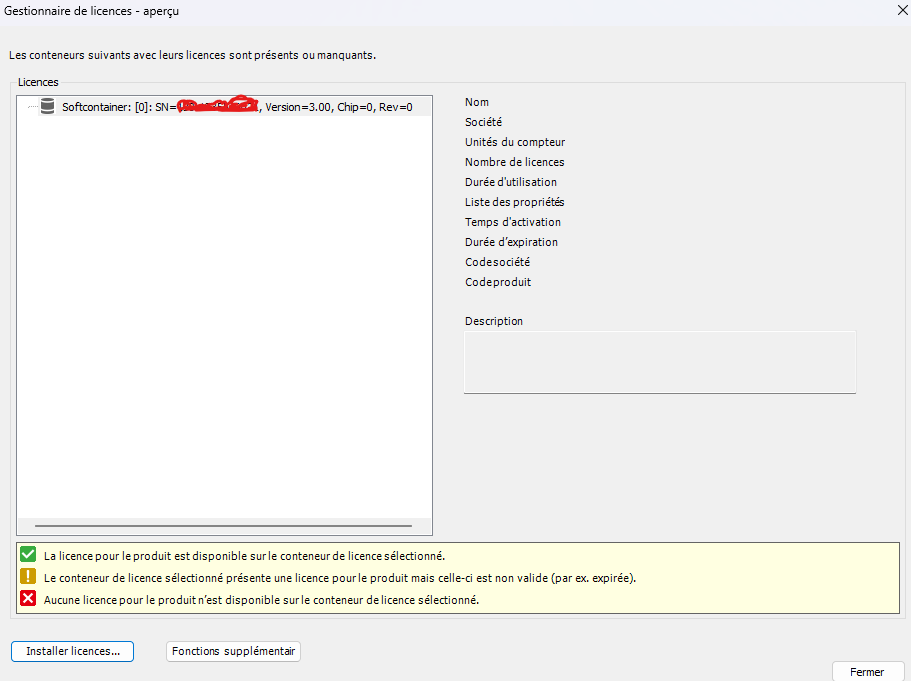

Despite receiving an activation message after entering the license number, I don’t have any license installed on my gateway.
I went to check in /var/opt/codesys/ and there is no License file.
I searched the entire gateway for a .lic file and found no license.
I’m really stuck—how can I fix this, please?
When I am using the licence tools I got this picture:
But nothing that have been activated.
The licence has been activated with a computer Name, but the guy who did it make a mistake in the name, so he changed it after to have activate the licence.
I think this has created a second container. The licence is actived on the other container.

I am using Codesys Control for linux ARM64 SL.
Installed with the SL deployment tool

I think I understand:
