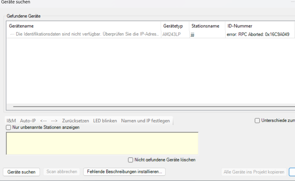

I am currently trying to use the AM243 LaunchPad as a PROFINET device and connect to it using CODESYS. In my setup I am also using a Raspberry Pi running the CODESYS PROFINET Runtime, which acts as the PROFINET controller. The setup of the Profinet controller is correct, so all devices are in the same subnet.
However, I encounter an issue when scanning for PROFINET devices in CODESYS. The AM243 LaunchPad appears in the scan results, but the following error is reported:
RPC Aborted: 0x16C9A049
Additionally, CODESYS shows the message that the identification data is not available and the IP address should be checked. Because of this error, the controller cannot establish a connection to the device.
Another observation is that I cannot ping the AM243 LaunchPad from my PC, even though I configured what should be the correct IP address.
Setup:
PROFINET Device: AM243 LaunchPad
PROFINET Stack: Industrial Communication SDK example
PROFINET Controller: Raspberry Pi running CODESYS with PROFINET Runtime
Engineering PC: CODESYS IDE
Network: Ethernet connection between PC, Raspberry Pi, and AM243
In the attachments there is a screenshot of the corresponding error. Did anybody had the same error?
Any hints or debugging suggestions would be greatly appreciated.
Thank you!
