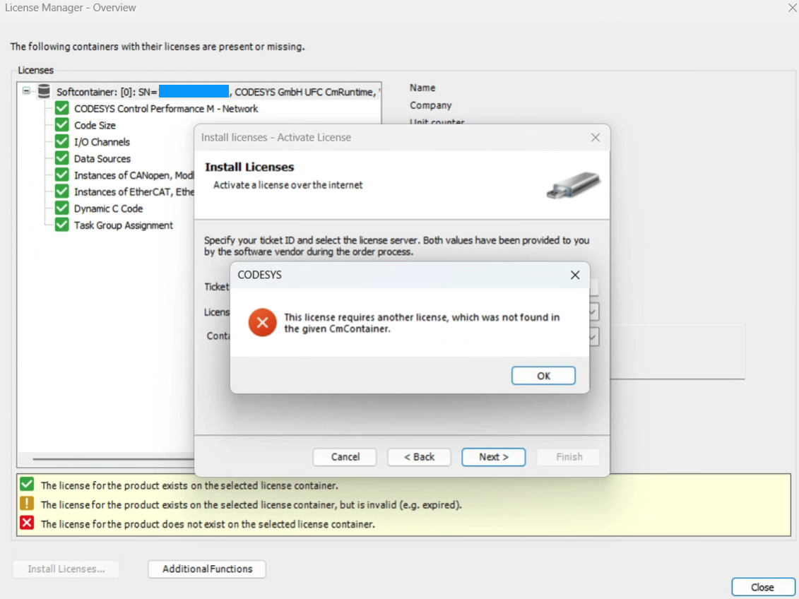

I have successfully activated a CODESYS Control Performance M on a Linux IPC. When I try to activate the CODESYS Visualization M license it fails with this error. Any ideas? This is a WAGO 752-9401 FW4, running Debian 12.
The fix for this is when you install the control SL license, there is a checkbox for the Visu S license option. You must click this option. The Visu M is technically an upgrade to the Visu S, if this is license is not installed them the Visu M will fail as shown above. Thanks JoJo for the solution!

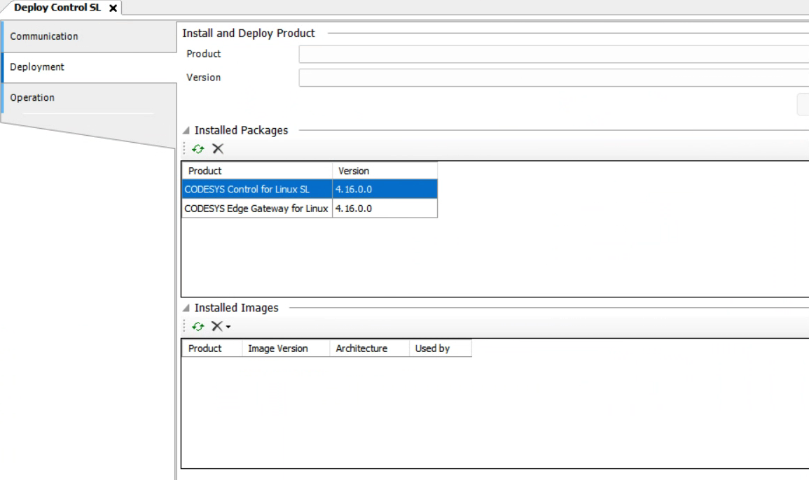

This is what is on the device, is this correct? I did not see an option to install TargetVisu, is this needed?
