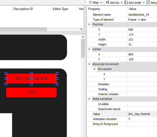

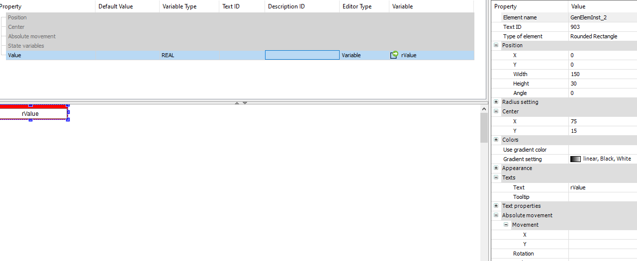

i want to make a frame for use multiple places for showing pressure and temperature. ive tried to decleare a variable in the frame config, if i put a fixed value in the value text field it show correct until i simulate. and if i point to a variable i gvl it show the name of the variable, and when i simulate it shows rValue. is there a way to do what i want?

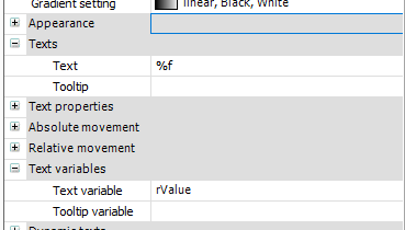

Put %f in the "text" field and rValue in the "Text variable" field.
You could also have a look at the possible placeholders:
https://content.helpme-codesys.com/en/CODESYS%20Visualization/_visu_placeholder_with_formatting_sequence_in_a_string.html
