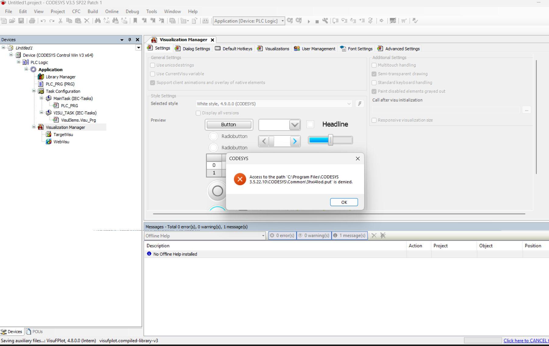

Hi to all,
I've created a project using the File->New Project-> Standard Project command.
Then I've add the object "Visualization Manager" and then tried to create a project archive (File->Project Archive->Save Archive), but it fails with the error "Access to the path 'C:\Program Files\CODESYS 3.5.22.10\CODESYS\Common\3hxi4iod.put' is denied".
The idicated file don't exist.
First time of use of the new Codesys versionΓΉ, I've reinstalled the developement software but nothing change.
If I don't add the Visualization part, the archive is created, it's seems to be a problem with the HMI part.
Any ideas?
Thanks

There is an issue with adding the visu styles to the archive with Visu add-on 4.9.0.0 and 4.9.1.0. When you create the projectarchive disable the option to add the style(s) to the archive. CODESYS support informed me it will be fixed with visu add-on 4.10.0.0 (May 26th 2026).
An alternative is to start CODESYS as Administrator. Then it will work with styles as well.
You could start CODESYS as Administrator by first opening the CODESYS Installer. At the bottom you can select to start the Installer as Administrator. If you do this and then start the CODESYS version from this installer, it will work.
Hello TimvH,
thanks a lot! :)
