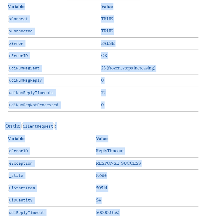

State observed when stuck
So the connection is alive, the request finished in ReplyTimeout, the FB
is back to _state = None, but udiNumMsgSent no longer increases β as if a
new rising edge on xExecute is no longer accepted / no longer produces a
new message.
new message.

Is there a known condition where, after ReplyTimeout, the
ClientTCP keeps xConnected = TRUE but silently stops sending new
requests (e.g. an internal request queue / _udiRequestId that gets out
of sync)? udiNumMsgSent freezing at 23 while the FB shows _state = None is what puzzles me.
