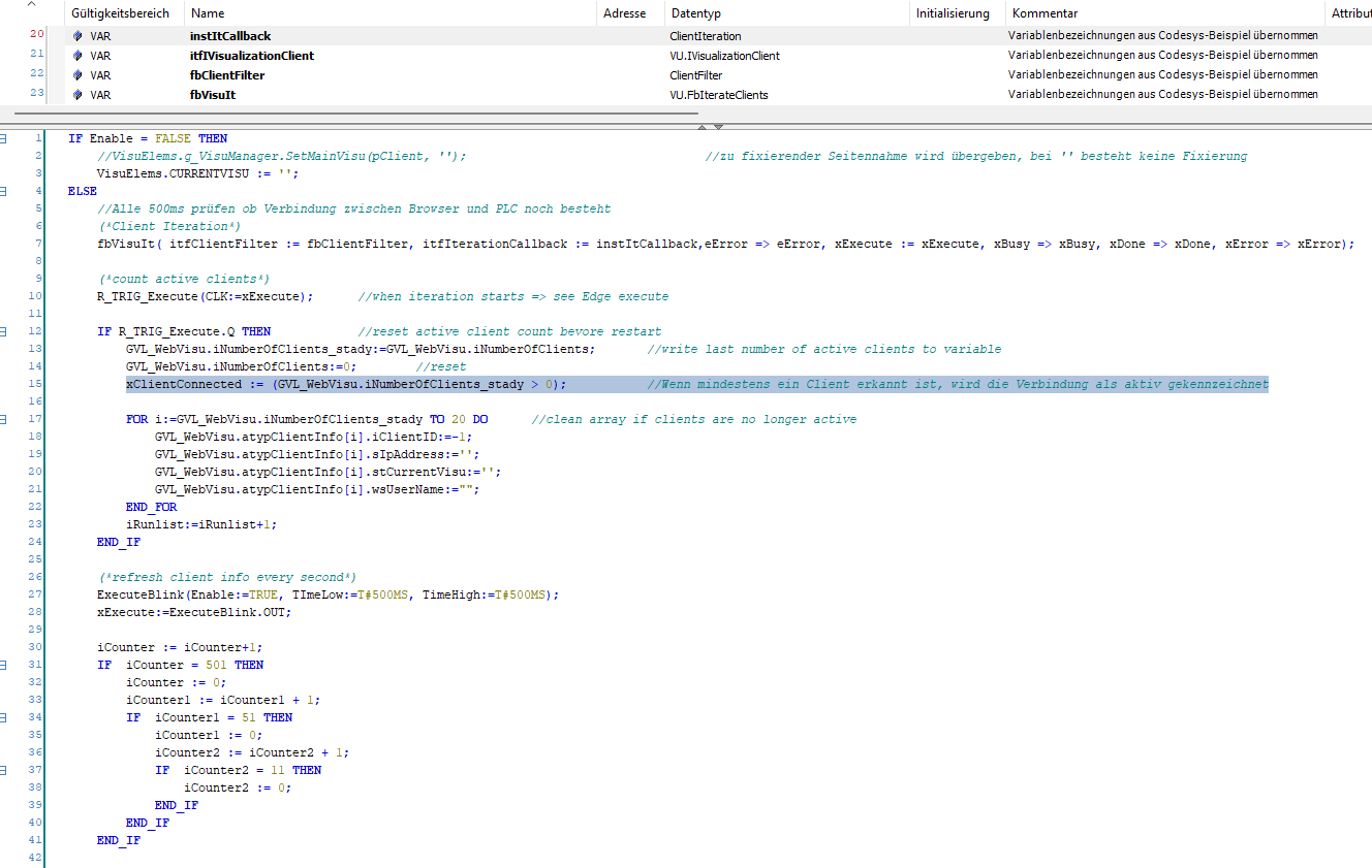

Ok, I figured out that I do not call the program in the main task.
Thank you for the source code, it works!

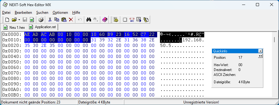

Hi,
I am interested in details about the .ret file in the filesystem. I have already a project where the file is used (write on demand, read by start) and I want to share it as 'default input' for test devices using the identical application.
Opening the .ret file content in a hex editor (I only use a single string retain var) I asked myself what the meaning of the first 24 bytes is. It neither contains a handle to the application nor a reference to the variable. Is this maybe a timestamp? Or a CRC/checksum?
