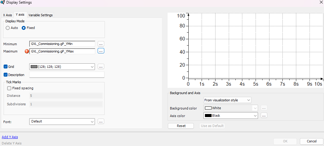

I am experiencing an issue when trying to define the Y-axis limits in a Trend Graphic using variables. When I set the Minimum and Maximum values as variables, an error is triggered.
My goal is to make the Y-axis limits dynamic so they can adjust according to the installation. Both variables are initialized as follows:
gP_YMin = -100.0
gP_YMax = 100.0
However, I still get the following error:
"The minimum axis value must be less than the maximum axis value"
Does anyone have an idea why this is happening or how to resolve it?
I am using real vars and it works, however, if I update those vars in real time it doesnt quite change it on y axis, do you think it is because it is not an integer?

Hi,
It was my fault. I was using a REAL variable instead of INTEGER. Sorry for posting this.
Hello Hannibal,
