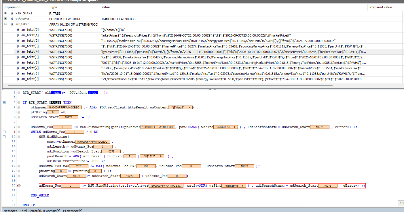

Hi i get a json value from an energy site. Every hour a value. to cut the answer in an array so i can read every hour it try FindWString . find Marketprice. But it turns in every array on a diverent position. Why ?
