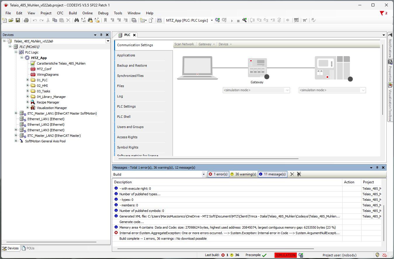

    Hi to all,
    I receive an error when I try to compile a project that in v.3.5.21.50 have no problem.
    The error seems to comes out when I add the Visualization part into the project.
    The complete error is:
    [ERROR] Internal error:System.AggregateException: One or more errors occurred. ---> System.Exception: Internal error in Code ---> System.ArgumentNullException: Value cannot be null. Parameter name: expLValue at _3S.CoDeSys.LanguageModelManager.LanguageModelBuilder.CreateAssignmentExpression(IExprementPosition pos, IExpression expLValue, IExpression expRValue, Operator kindof) at _3S.CoDeSys.LanguageModelManager.LanguageModelBuilder.CreateAssignmentStatement(IExprementPosition pos, IExpression expLeft, IExpression expRight) at ..(IExpression , IExpression ) at ..(_IAssignmentExpression ,  ) at _3S.CoDeSys.Compiler35220.Phase5_Codegeneration.Optimization.AssignmentStatementReplacer.ReplaceExpressionStatement(_IExpressionStatement expressionStatement, _ICompiledPOU cpou) at _3S.CoDeSys.Compiler35220.Phase5_Codegeneration.Optimization.ExpressionStatementReplacerVisitor.visit(_ISequenceStatement sequenceStatement) at _3S.CoDeSys.Compiler35220.Phase5_Codegeneration.Optimization.ExpressionStatementReplacerVisitor.visit(_IIfStatement ifst) at _3S.CoDeSys.Compiler35220.Phase5_Codegeneration.Optimization.ExpressionStatementReplacerVisitor.visit(_ISequenceStatement sequenceStatement) at _3S.CoDeSys.Compiler35220.Phase5_Codegeneration.Optimization.ExpressionStatementReplacerVisitor.visit(_IIfStatement ifst) at _3S.CoDeSys.Compiler35220.Phase5_Codegeneration.Optimization.ExpressionStatementReplacerVisitor.visit(_ISequenceStatement sequenceStatement) at _3S.CoDeSys.Compiler35220.Phase5_Codegeneration.Optimization.ExpressionStatementReplacerVisitor.visit(_IForStatement forloop) at _3S.CoDeSys.Compiler35220.Phase5_Codegeneration.Optimization.ExpressionStatementReplacerVisitor.visit(_ISequenceStatement sequenceStatement) at _3S.CoDeSys.Compiler35220.Phase5_Codegeneration.Optimization.ExpressionStatementReplacerVisitor.visit(_ISequenceStatement sequenceStatement) at ..(_ICompiledPOU ) at ..(_ICompiledPOU ) at _3S.CoDeSys.Compiler35220.Phase5_Codegeneration.Codegeneration.(_ICompiledPOU , _ISignature ) at ..(_ICompiledPOU ) at ..(_ICompiledPOU& ) at ..() --- End of inner exception stack trace --- --- End of inner exception stack trace --- at _3S.CoDeSys.Compiler35220.CompilerPhases.CompilerPhase5_Codegenerator.(IList1 ) at _3S.CoDeSys.Compiler35220.CompilerPhases.CompilerPhase5_Codegenerator.(IScope5 , IList1 ) at _3S.CoDeSys.Compiler35220.CompilerPhases.CompilerPhase5_Codegenerator.(ICodegenerator ) at _3S.CoDeSys.Compiler35220.CompilerPhases.CompilerPhaseControllerGenerateCode.() at _3S.CoDeSys.Compiler35220.CompilerPhases.CompilerPhaseControllerGenerateCode.() ---> (Inner Exception #0) System.Exception: Internal error in Code ---> System.ArgumentNullException: Value cannot be null. Parameter name: expLValue at _3S.CoDeSys.LanguageModelManager.LanguageModelBuilder.CreateAssignmentExpression(IExprementPosition pos, IExpression expLValue, IExpression expRValue, Operator kindof) at _3S.CoDeSys.LanguageModelManager.LanguageModelBuilder.CreateAssignmentStatement(IExprementPosition pos, IExpression expLeft, IExpression expRight) at ..(IExpression , IExpression ) at ..(_IAssignmentExpression ,  ) at _3S.CoDeSys.Compiler35220.Phase5_Codegeneration.Optimization.AssignmentStatementReplacer.ReplaceExpressionStatement(_IExpressionStatement expressionStatement, _ICompiledPOU cpou) at _3S.CoDeSys.Compiler35220.Phase5_Codegeneration.Optimization.ExpressionStatementReplacerVisitor.visit(_ISequenceStatement sequenceStatement) at _3S.CoDeSys.Compiler35220.Phase5_Codegeneration.Optimization.ExpressionStatementReplacerVisitor.visit(_IIfStatement ifst) at _3S.CoDeSys.Compiler35220.Phase5_Codegeneration.Optimization.ExpressionStatementReplacerVisitor.visit(_ISequenceStatement sequenceStatement) at _3S.CoDeSys.Compiler35220.Phase5_Codegeneration.Optimization.ExpressionStatementReplacerVisitor.visit(_IIfStatement ifst) at _3S.CoDeSys.Compiler35220.Phase5_Codegeneration.Optimization.ExpressionStatementReplacerVisitor.visit(_ISequenceStatement sequenceStatement) at _3S.CoDeSys.Compiler35220.Phase5_Codegeneration.Optimization.ExpressionStatementReplacerVisitor.visit(_IForStatement forloop) at _3S.CoDeSys.Compiler35220.Phase5_Codegeneration.Optimization.ExpressionStatementReplacerVisitor.visit(_ISequenceStatement sequenceStatement) at _3S.CoDeSys.Compiler35220.Phase5_Codegeneration.Optimization.ExpressionStatementReplacerVisitor.visit(_ISequenceStatement sequenceStatement) at ..(_ICompiledPOU ) at ..(_ICompiledPOU ) at _3S.CoDeSys.Compiler35220.Phase5_Codegeneration.Codegeneration.(_ICompiledPOU , _ISignature ) at ..(_ICompiledPOU ) at ..(_ICompiledPOU& ) at ..() --- End of inner exception stack trace ---<---

    actualy I've solved the problem by creating a new project and copying the file.
