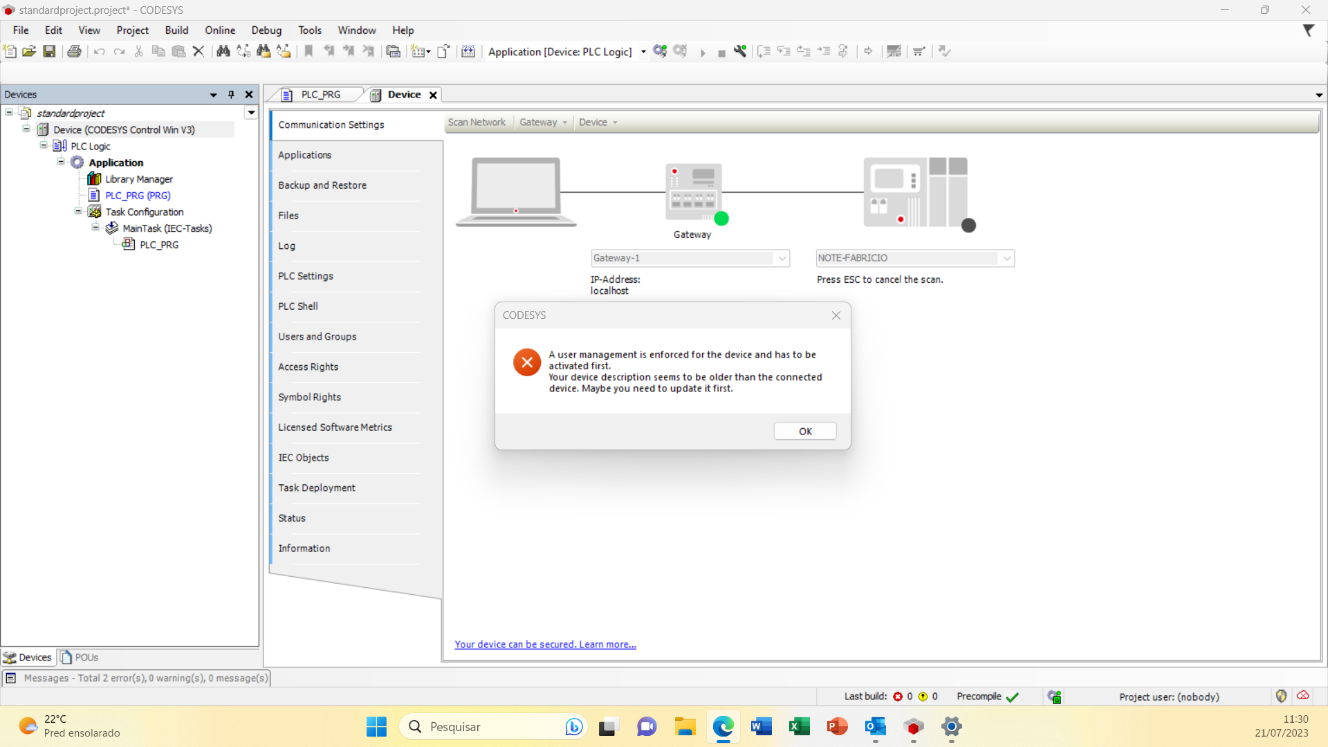

Hi!
Anyone can help me with this error?
"A user management is enforced for the device and has to be activated first."
"Your device description seems to be older than the connected device. Maybe you need to update it first."
Like that
just select the device in the CODESYS device tree - then rightclick on that and execute 'update device' to current/proposed version - if you are using CODESYS Development System 64Bit - change the Control Win to Control Win x64 to be able to login to your local Control Win x64 instance
(start your plc in the tasktray - then scan it and login to it)
