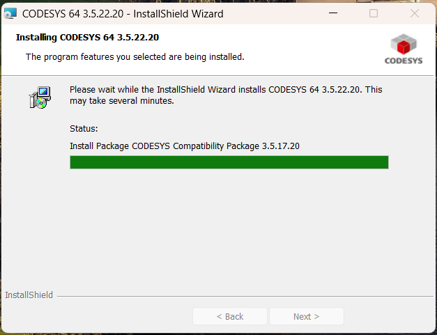

I am attempting to install CODESYS 3.5.22.20 and the installer gets stuck at "Install Package CODESYS Compatibility Package 3.5.17.20" every single time. I've tried reinstalling the software multiple times and the same issue persists. I've tried running the installer as an administrator and even turned off my virus protection and the same issue persists. I've attached a photo for reference.
Has anyone run into this issue before or have any idea what I can do to complete the install?
I had an issue when my organization installed some security software that blocked scripts. The installer would silently hang at the same point every time. I had to get a network admin to make some change to security software that wasn't immediately visible to me as a user to allow the installation script to run.
