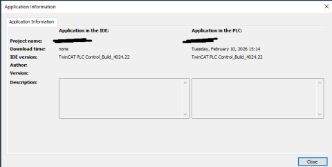

what is CODESYS message : an application 'application' is currently in RUN mode on the PLC. As there is no matching complie information, this existing application needs to be replaced.
this mean your project dont have compile information. try to upload code from PLC and them go online.
To know the differences between online program and your project clica in Details, when the message pop-up.

I have the same issue, and no answers on any forums that I can see.
