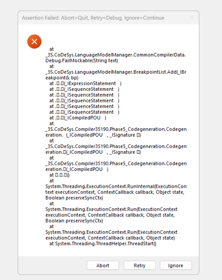

Any idea what this is? I get it every time I try to compile a program. The only way around it is to click "Ignore" about 50 times. After that the program compiles and runs fine.
I had similar assertion failed error messages today.
I am fairly new to Codesys.
I tried using SFC for the first time, I usually use ST.
Anyway I had errors in some of my transitions.
I copied and pasted transition code and forgot to change the target of the code.
I started getting lots of the assertion errors but now I have sorted out the problems and it compiles OK the assertion error messages seem to have stopped.
