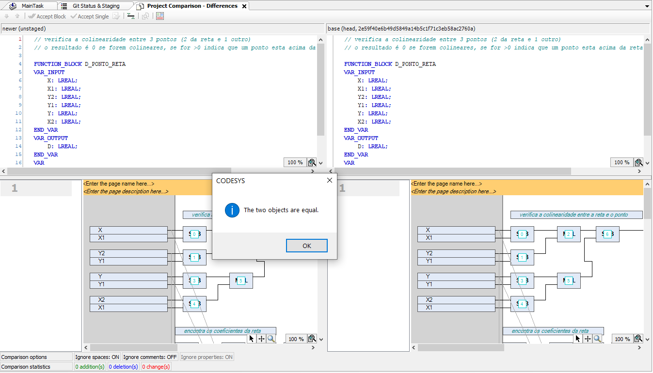

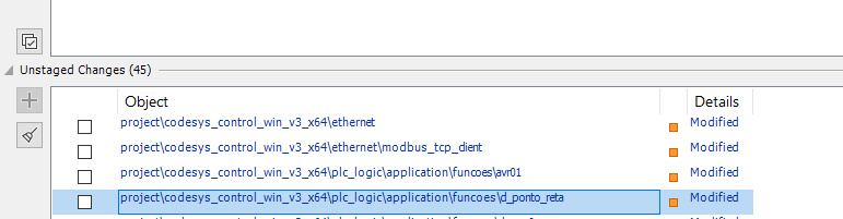

I'm having a serious issue with codesys-pro/git, because everytime I load my project I get around 40 unstaged changes with equal objects. If I only commit everything along with my real changes I strugle to locate them later. I've tried creating a new git repository, it didn't work. I've commited everything, it kept appearing. I've tried rolling back everything but it also didn't work. Does anyone know why this happens and how to manage it?
Hi -- curious to know the same thing! Lots of "The objects are equal" randomly popping up... my solution (for now) is simply to commit the actual changes and then execute the rollback (git clean + checkout) on all that are giving me the issue in question. Does anyone know if this repairable?
