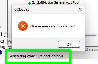

Trying to utilize the persistence manager, but system do not write to file and do not create the config file.
System is a Linux SL, version 4.13.0.0
Problems with persistence/config started when I had other problems to go online, I deleted the config file and the persistent files, but the system will not re-create them. I have tried to remove/re-install the "PersistenceManager"-module, create the folder-structure myself. And also reinstall the linux-runtime but its clearly not working. Any help appreciated.
Also. Every third (or so) attempt to login/compile is unsuccessful with the error prompt "one or more errors occurred", however there is no information available on what this error might be. If I remove the PersistenceManager-module, these problems are not present.
Thats what I did. The files existed originally, but when I had problems logging in as described I deleted those files (if they in some way had been corrupted causing my problems to login?). After that I have not managed to get the system to re-created these def-files. I manually created the folder structure (from CODESYS file browser) but this has not helped.

Back in november I paused this, but wanted to reattempt using the persistent manager, the behavior is still the same. Most "login attempts" s are stopped with the message "One or more errors occurred" but I have no idea what that error might be. The only clue is this message is presented while the lower left status box says "Generating code...: relocation pou".
For clarification. Build/Generate code is successful, no errors. Error appears when I try to download/login (physical or simulation) to a device.
I did manage to login (in simulation mode) at one point, but then the error message "PersistenceChannel: Config file not found!". And no persistence files were created.
I have done device-tree/reset-orgin also clean/clean all etc. Removed/re-inserted persistance manager. Behaviour is just the same. Removing Persistence Manage and everything is working OK.
Is there possibly more info somewhere about the "One or more errors occured"-message?
I still cannot enable persistent manager for my project (and successfully login to a device). Project compiles with no errors but during download/login it fails with the fairly limited message "one or more errors occurred".
The only clue I get from the system that this messages is displayed during "Generating code..: relocation pou".
Any tips pointing me in a direction how to solve this very much appreciated!

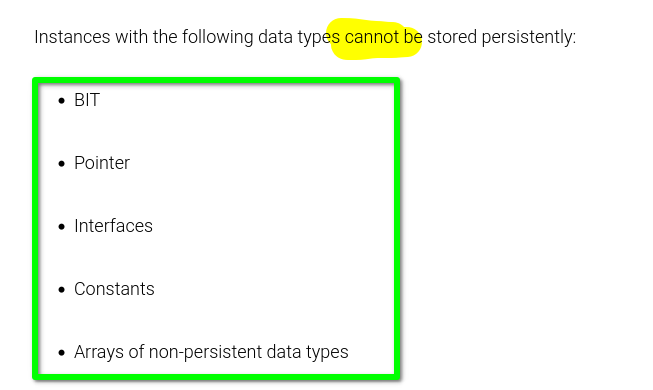

Ok, think I understand. The reason for the error is I try to include complex variables (FB) in the persistenced data.
I will try to use {attribute 'ac_persist_exclude'} to exclude those elements.
Confirmed.
Variable types that should be excluded:
BIT
Pointer
Interfaces
Constants
Arrays of non-persistent data types
Docs:
https://content.helpme-codesys.com/en/CODESYS%20Application%20Composer/ac_pm_definition_persistent_variables.html
Thank you, I have successfully fixed that error.
