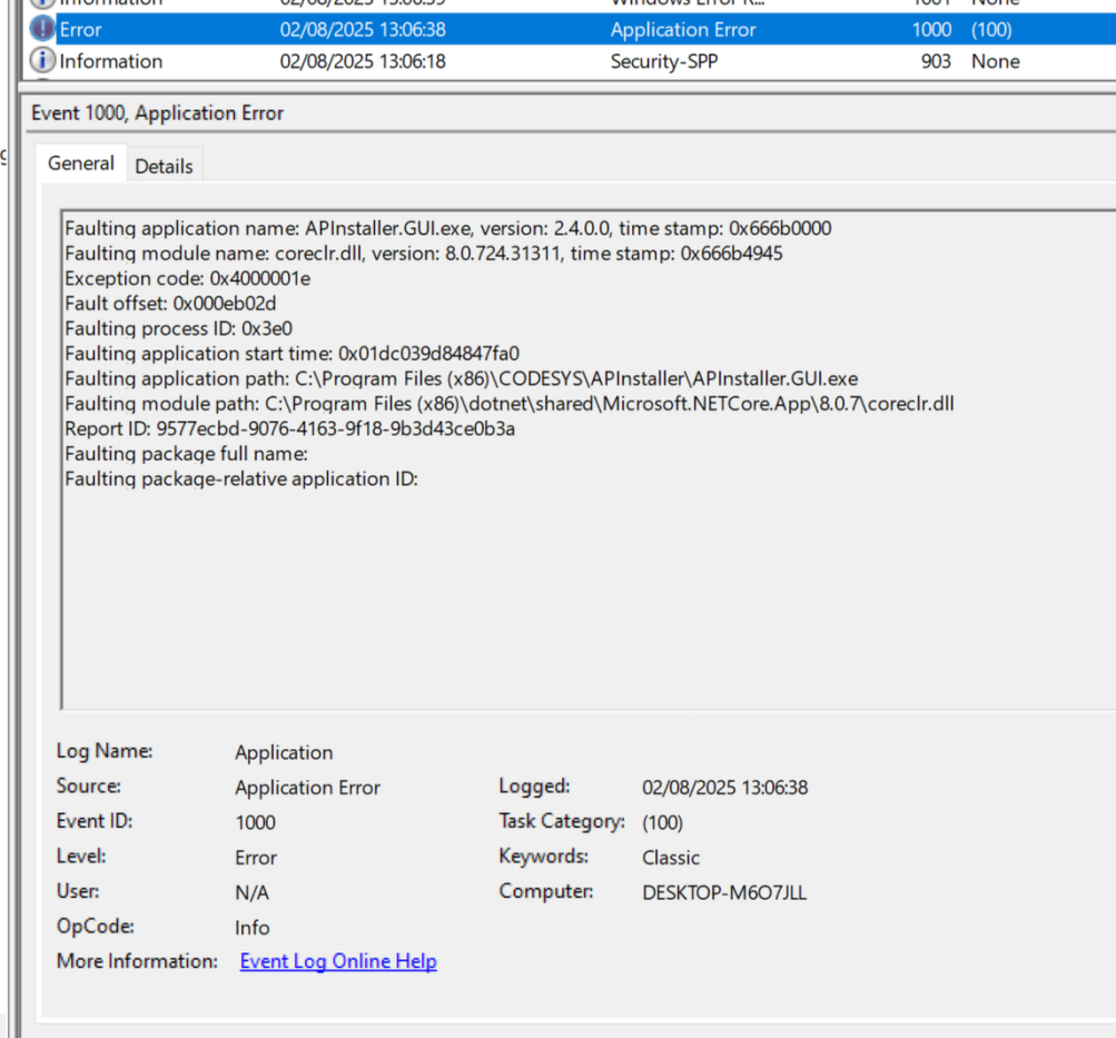

Hello,
I have similar issue - installed CODESYS 64 3.5.21.10 on clean Win10 VM (virtualbox). Windows defender switched off, no additional antivirus.
Codesys installer not starting (normal user and admin). No errors displayed.
Windows event log screen in attachment.

Hello,
