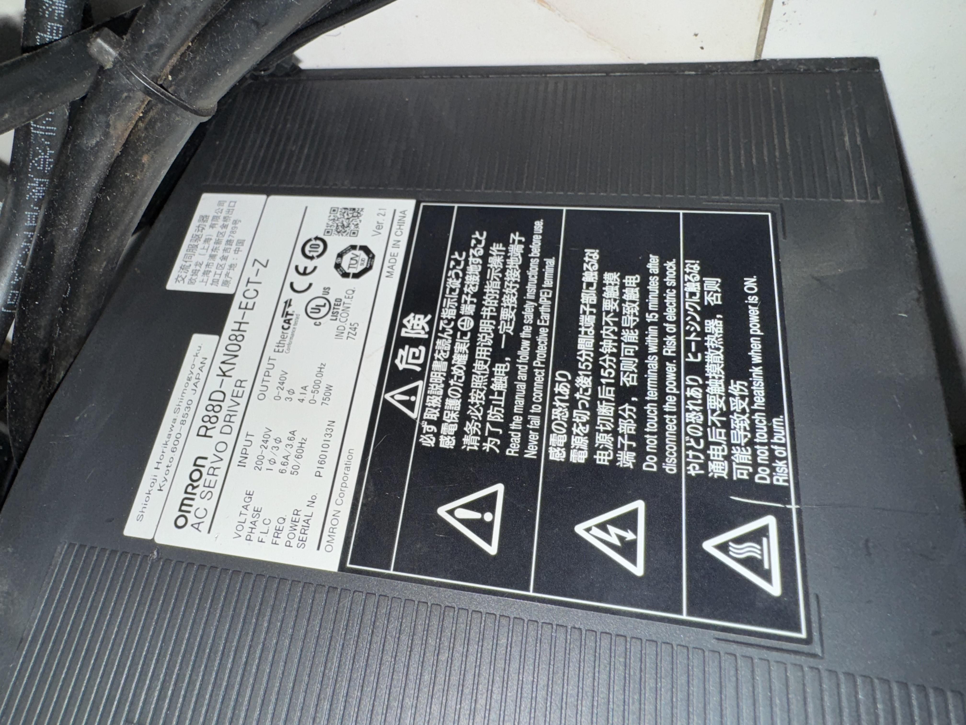

hi everyone, continuing the part about omron g5 axis and nx-ecc201 omron, but i have a problem with not being able to scan with "model with Z code suffix of omron china", it seems that the available softmotion file is not fully compatible mapping, often causing ethercat communication error DC distributed clock after every 10-12 hours of continuous running!
omron driver: R88D-KN08H-ECT-Z
