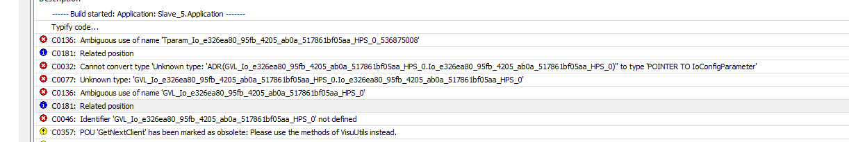

  • mike197678 - 2016-11-10
    great,
    and the mac adress?
    thx
  • eschwellinger
    eschwellinger - 2016-11-10
    Hi,
    yes even this is possible:
    You need to ad 'CmpSysEthernet' to the LibraryManager
    then then the following code snippet should help.
    getnumberofadapters(ADR(diNumber));
    FOR iAdapter := 0 TO diNumber DOPROGRAM PLC_PRG
    VAR
       diNumber: DINT;
       iAdapter: DINT;
       stName: STRING(255);
       stDescription: STRING(255);
       aby_address:ARRAY[1..6]OF BYTE;
    END_VAR
       getadapterinfo(
       iAdapterNum := iAdapter,
       pbName := ADR(stName),
       pbDescrition := ADR(stDescription),
       iBuffersize := SIZEOF(stName),
       iMacLength := 6,
       sMacAdress := ADR(aby_address));
    END_FOR
    BR
    Edwin
    IMG: mac.jpg
  • mike197678 - 2016-11-11
    Thank You,
    work perfect.
    Thank you very much
