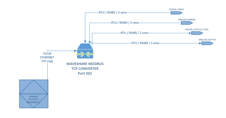

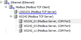

Hi there,
Read the above description and experienced the same: Reading coil/discrete input/input register/holding register doesn't fill the mapped I/O variable.
Any suggestions?
Defined (see attachment):
Writing coil/holding register works from a mapped I/O variable works fine.
Verification of Modbus traffic with WireShark:
QUERY to and the RESPONSE of all slave-ids are correct
Status of all defined is CONNECTED, RESPONSE_SUCCESS, RUNNING etc.
Request counters increase with expected frequency. Error counter = 0.
(To have all counters works fine I had to change Modbus TCP Client's parameter OptimizationON to FALSE).
LOGO231 works fine: values in mapped I/O conform expectation
WS242 without Modbus Server, COM port and
with defined channels (for only 1 slave-id possible) works fine.
PLC Settings:
Update I/O while in stop: I see xBusy changing from FALSE to TRUE and vice versa.
Always update variables: Enabled 1
your case looks different, the first one was an codesys modbus tcp-slave, your's an Master-Application with gateway.
I dont know this Unit, but i would say, from Point of Codesys it looks wrong configured.
Just give us more detailed configuration and the please make a sketch of the topology you're trying to realise.

You're absolutely right. Sorry for that.
In the meantime I wrote a Function block to handle the reads and writes to the different attached RTU-devices.
It processes the parameter like (str_Modbus:=(usiSlave:=1, uiFC:=5, uiLEN:=1, uiOFFSET:=0, uiInterval:=500)) and the corresponding output, waits for the response and processes next request in a 5-state procedure. It's working for 2 gateways (stable without errors, although error recovery is included).
But nevertheless it should be possible with the Channel definitions of Codesys. Much easier to maintain :)
it works pretty well on codesys-version using device-tree and channels. heres the twist: each uid should be represented as a device, which in your case, it isn't.
on the other hand, you found a solution which already works fine.
Happy Modbus'ing
