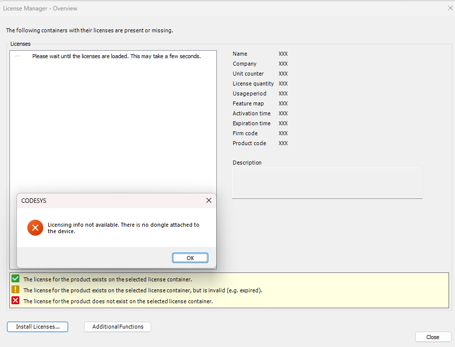

Hello,
I bought some licenses from CODESYS store.
I am trying to install licenses into my device(CODESYS Control for Linux ARM64 SL). But I have a trouble with it.
I did it in the following order.
Could you let me know what I've missed or what I've got wrong?

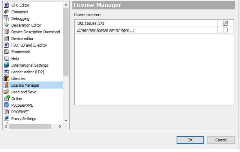

Dear Forum
I have the following config:
Codesys_IDE 3.5.20
Codesys_Virtual_Control 4.13
Codesys_License_Server 4.13
I know these are not the newest versions, but in my mind these should work.
I have the same problem here. I have the license server installed on the host, and in the docker container(Codesys virtual control) I'm able to ping the license server. In the /conf/codesyscontrol/CODESYSControl_User.cfg I have added the following config:
[CmpCodeMeter]
EnableNetLicenses=1
LicenseServer.1="ip address of the host"
I have tried it via the wbm web-page. I can create new license containers over there, but still no luck.
I also have tried to run the docker container with the -s "server_IP" command.
I have searched for some tutorial's but I couldn't find it.
If anyone has some clue or can give me a push in the right direction it would be very very welcome!
Last edit: alexgooi 2025-09-29

Dear Eschwellinger,
Thank you for the response.
Does that mean that the license-manager inside the Codesys-IDE does not work with this setup anymore?
Because when I use this I get the notification that there is no dongle attached to the device (see picture).
And If I insert the license by the deploy tool, can I then redeploy the Codesys virtual control container, or does this erase the license completely?
yes and no ... if you run the license server on the host (to serve licenses to the docker instances / vplcs then there is no runtime which could check the licenses on the host.
Therefore you need the CODESYS WBM to activate or check the licenes or you could use in CODESYS IDE the licensemanager ( not the one for the device licenses) but you have the the IP of the license server that he know where to search for the licenses ..tool options i guess to add it, will add a screenshot later.

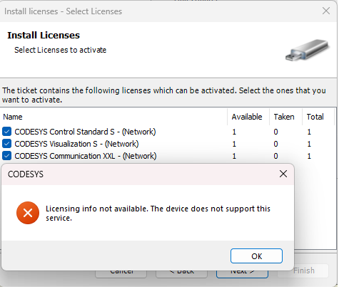

Thank you for your quick response,

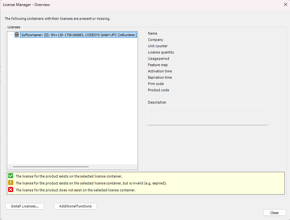

I have updated to the 4.17.0 (Virtual control and the license server).
Now I am able to see the softcontainer from the Codesys IDE.
But when I want to activate the license I get the following message:
Licensing info not available. The device does not support this service (See picture).

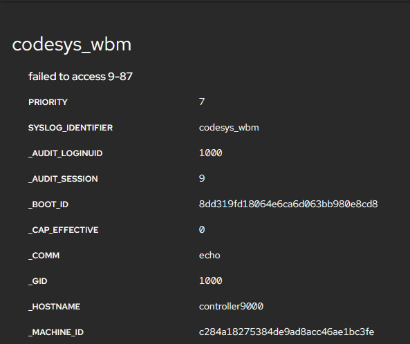

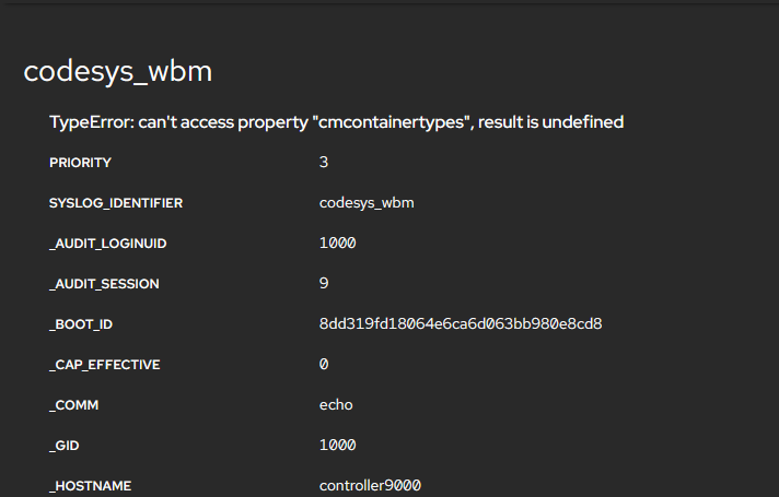

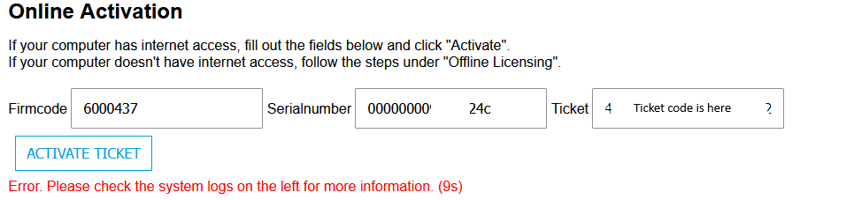

I then tried to active it via the WBM service like you suggested.
But when I try this is get an error (see picture for error).
I also tried to put RTS- in front of the serial number, but when I try this I get an error that the serial number is not correct.
I think I'm getting closer, but I'm not there yet.
