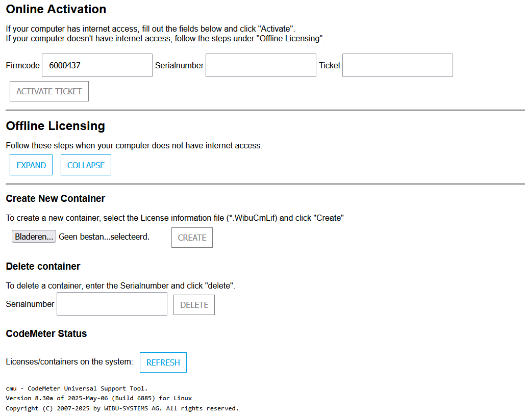

I'm now in a state where I don't have a softcontainer on my license server anymore (even after reinstalling from the Codesys-IDE). I tried reaching the webserver of Codemeter but when I do that I get redirected to http://"IP":22352
This is not reachable, afterwards I installed lynx on my Debian machine (command line only). From here I could reach the webserver and toggle the network server setting, but unfortunately this did not help. I also tried to changed the remote read setting to 1 (in the Server.ini file). But after a Codemeter reboot this is overwritten to 0.

the procedure is usually
1. install the Licenserver (on the host) with the deploy tool in CODESYS)
2. if you go to the CODESYS WBM you should see an empty Softcontainer 130-xxxxxx
3. activate the license with SoftContainer number and ticketnumber
that was it!

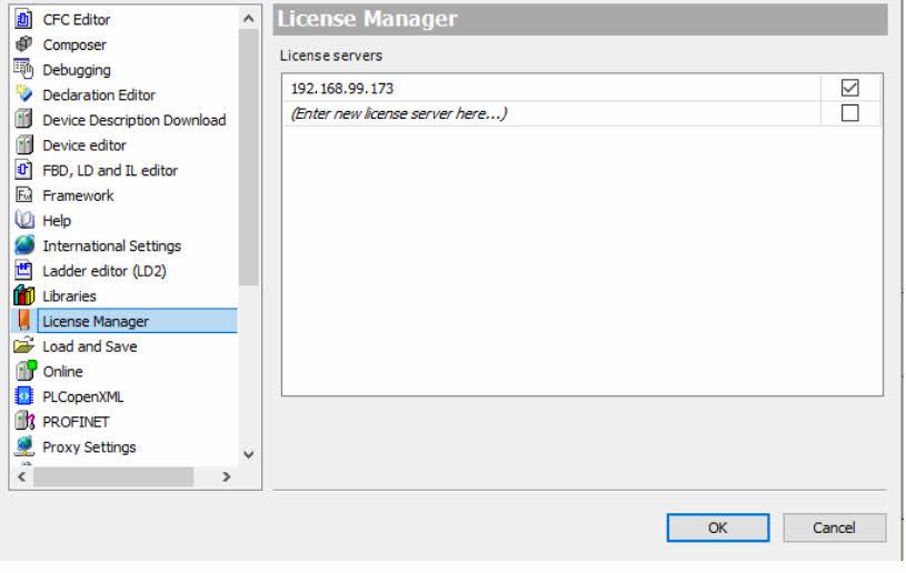

In the VPLC configuration settings there is an entry for the IP address of the license server. In this setting fill in the IP address of your device (host IP address). Then when the virtual PLC starts up, it will get the license from the license container on the host. You can do this for all VPLC's running on your device. The VPLC will always take the smallest license which fits the required license. So if you have 2 licenses for VPLC's with small and large applications, then this will work fine if you start up one VPLC which requires the small license and the other which requires the large license.

add the Container serial number this is usually 130-xxxxxxxx and last row the license ticketnumber which you got from the CODESYS Store order
