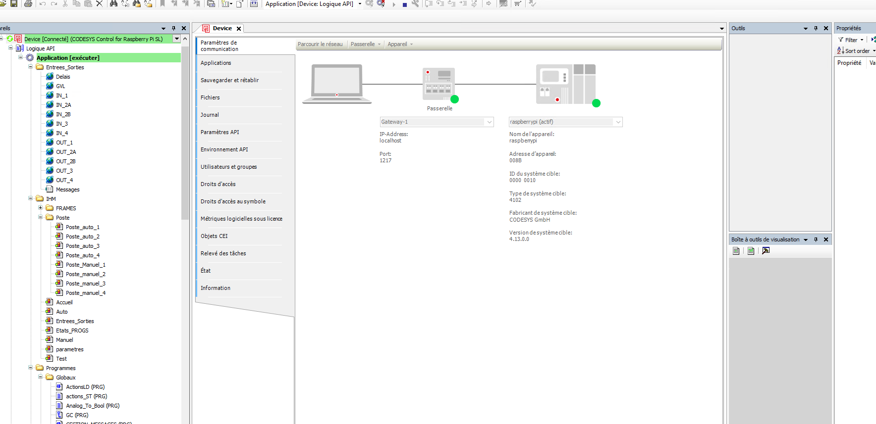

Hello everyone, following corrupted data on the SD card of our Pi3B+ provided with a machine,
we reinstalled a CODESYS image for Raspberry Pi, but we cannot find the 4.9.0.0 runtime that is compatible with the project. Currently, the machine is on 4.1.0.0, and we tried a more recent version 4.13.0.0, but there are error messages.
Thanks in advance.

yes but impossible to upload runtime 4.9.0.0
now we have put an image on the sd card with 4.13.0.0, i have 27 error message to this type, and if i test some output not work, et some work
------ Processus de compilation entamé : application : Device.HiddenOnlineConfigModeApp ------- Affecter un type à un code... [ERREUR] conditionneuse_camphre-ssa-05-02-24-V3 maj 241025: C0032: Le type 'Type inconnu : 'ADR(GVL_Io_73f6cbf3_7be8_4500_8421_47e565d899a0_HPS_1.Io_73f6cbf3_7be8_4500_8421_47e565d899a0_HPS_1)'' ne peut pas être converti en type 'POINTER TO IoConfigParameter' [ERREUR] conditionneuse_camphre-ssa-05-02-24-V3 maj 241025: C0077: Type inconnu : 'GVL_Io_73f6cbf3_7be8_4500_8421_47e565d899a0_HPS_1.Io_73f6cbf3_7be8_4500_8421_47e565d899a0_HPS_1' [ERREUR] conditionneuse_camphre-ssa-05-02-24-V3 maj 241025: C0046: Identificateur 'GVL_Io_73f6cbf3_7be8_4500_8421_47e565d899a0_HPS_1' non défini [ERREUR] conditionneuse_camphre-ssa-05-02-24-V3 maj 241025: C0032: Le type 'Type inconnu : 'ADR(GVL_Io_1b6dcc3b_ae11_4288_b9a9_86f9323448d1_HPS_1.Io_1b6dcc3b_ae11_4288_b9a9_86f9323448d1_HPS_1)'' ne peut pas être converti en type 'POINTER TO IoConfigParameter' [ERREUR] conditionneuse_camphre-ssa-05-02-24-V3 maj 241025: C0077: Type inconnu : 'GVL_Io_1b6dcc3b_ae11_4288_b9a9_86f9323448d1_HPS_1.Io_1b6dcc3b_ae11_4288_b9a9_86f9323448d1_HPS_1' [ERREUR] conditionneuse_camphre-ssa-05-02-24-V3 maj 241025: C0046: Identificateur 'GVL_Io_1b6dcc3b_ae11_4288_b9a9_86f9323448d1_HPS_1' non défini [ERREUR] conditionneuse_camphre-ssa-05-02-24-V3 maj 241025: C0032: Le type 'Type inconnu : 'ADR(GVL_Io_5ae6fa5a_c197_4038_9581_03e1650806a0_HPS_4.Io_5ae6fa5a_c197_4038_9581_03e1650806a0_HPS_4)'' ne peut pas être converti en type 'POINTER TO IoConfigParameter' [ERREUR] conditionneuse_camphre-ssa-05-02-24-V3 maj 241025: C0077: Type inconnu : 'GVL_Io_5ae6fa5a_c197_4038_9581_03e1650806a0_HPS_4.Io_5ae6fa5a_c197_4038_9581_03e1650806a0_HPS_4' [ERREUR] conditionneuse_camphre-ssa-05-02-24-V3 maj 241025: C0046: Identificateur 'GVL_Io_5ae6fa5a_c197_4038_9581_03e1650806a0_HPS_4' non défini [ERREUR] conditionneuse_camphre-ssa-05-02-24-V3 maj
i m not familiar with installation/firmware/version/runtime, juste the machine worked fine before, and now kaput lol

i have update the package 4.13 n the computer and install all update for all package, now impossible to start codesys... when i start to open any project i have a message invalid project...
sorry I missed to say how to do this just update the runtime.
(extract latest debian package out of the CODESYS package)
but 8n this case an update all to the latest version including CODESYS is probably the easiest option now.
