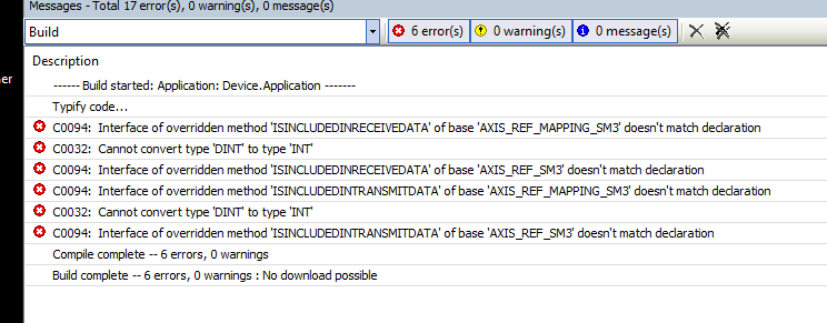

Hi Helpers
I'm trying to work with stepper motor on Rasp 5 for the first time. So I'm pretty new.π₯here.
I've used: https://forge.codesys.com/drv/sm3raspistepper/home/Home/
but I get the following error when I insert.
I also get 6 errors when I "rebuilder" after installering "SM_Drive_RaspStepper_direct" from the tree.
Hope there is help for me.
Thanks in advance
/Klaus

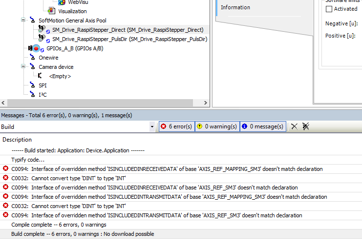

I have installed:
SM_Drive_PosControl 4.18.0.0 and
SM_Drive_RaspiStepper_Direct 0.0.0.7 and
SM_Drive_RaspiStepper_PulsDir 0.0.0.7
And when I "Generate Code" I immediately get 6 errors (see attached file)
I AM VERY GRATEFUL FOR YOUR HELP.
I HAVE INSTALLED: CODESYS SOFTMOTION VER. 4.19.0.0 AS SEEN IN THE ATTACHED FILE.
BUT IT DOESN'T CHANGE THE FACT THAT I GET 6 ERRORS WHEN I HAVE INSTALLED SM_Drive_RaspiStepper_Direct
DO YOU HAVE ANY SUGGESTIONS ON WHAT I CAN DO NOW?
/KLAUS

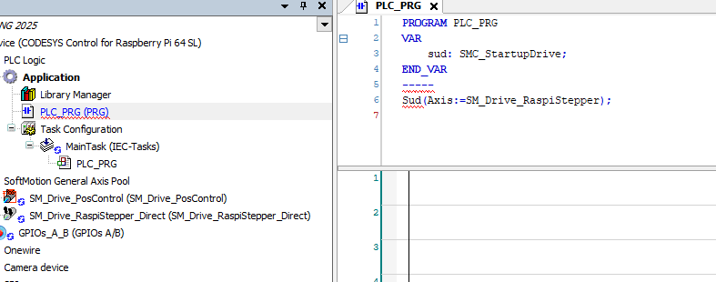

HERE IS MY PLC_PRG
/KLAUS
Which SoftMotion version is installed?
Last edit: eschwellinger 2025-11-06

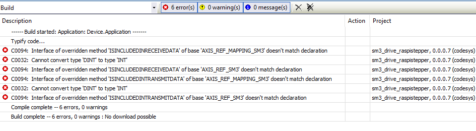

I have installed:
What can I do?????
..the missing part is which Softmotion version is installed.
Check it in the CODESYS Installer and update it to latest version.
