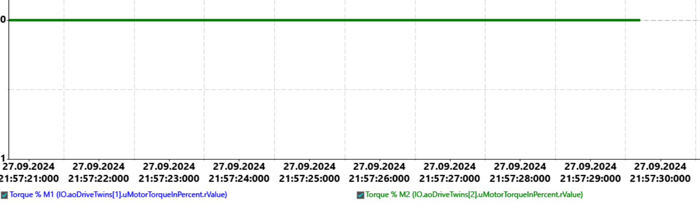

Hello, I have a question regarding the Trend and LegendDisplayer visualization elements. As the provided image suggests, I am trending two variables which show the torque of two motors in terms of % of max load. Below the trend element, is the LegendDisplayer element which correctly displays the name of both trends. But also, it displays the actual variable name in parenthesis, which I do not want. Currently, the name is set by entering a description for each variable in the trend recording settings. But I can't seem to find any option to display only this description. Is it possible to only remove the variable name used in the software?

I'm using CODESYS 3.5.21.50.

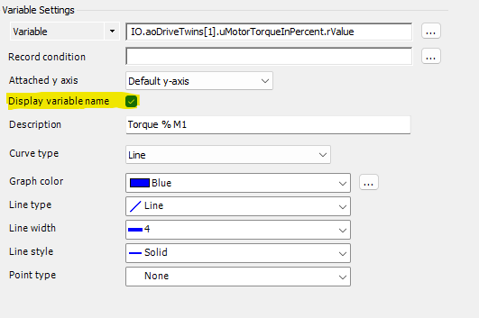

I seem to have missed the "Display variable name" option in the trend recording. This fixed the issue.
