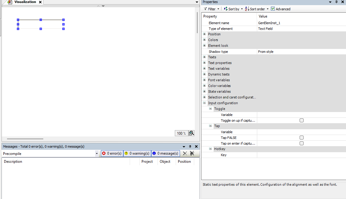

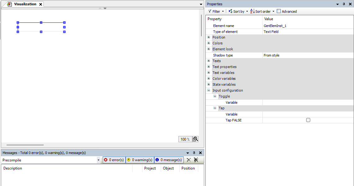

i hope i will get a solution for following problem. I am using CODESYS v3.5 SP18. At the visualization i dont see the action for the element which i could set below the InputConfiguration-Section. I found a topic about that, but this could be resolved through activate the Advanced Checkbox. But in my case it did not work. See the screenshots. I hope someone know this problem and have a solution. Thank you in advance.
Thanks, but unfortunately it does not work. I tried also the other function in the Properties window. What i tried also is to change the Visu-Style or looking for options.
I am so sorry this topic was posted twice and the subject is not completely. It should named like "CODESYS v3.5 SP18 - Missing Action".
click at "Filter" left from advanced and activate "all categories"
