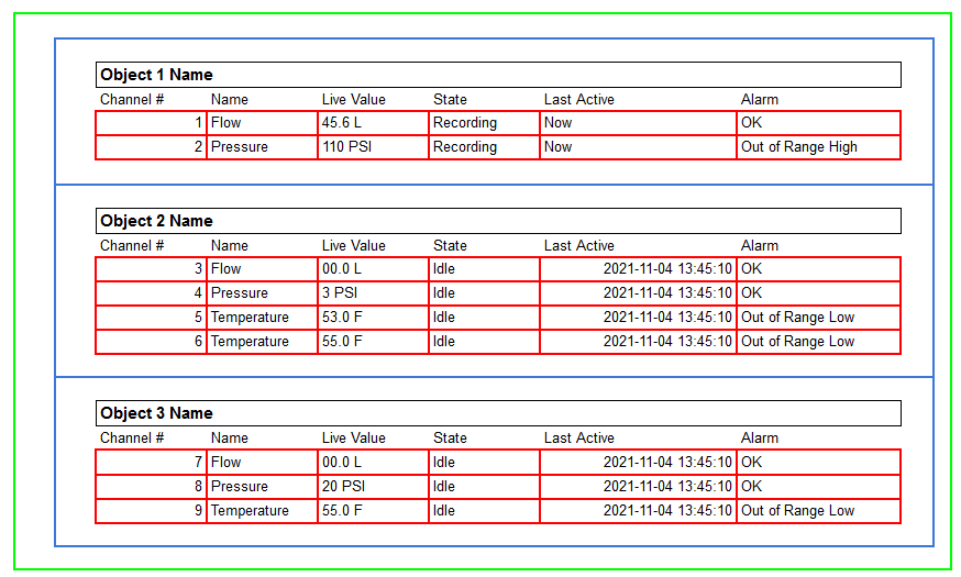

    Creating dynamic nested components is pretty trivial in Qt, WPF, and Blazor etc. Is there any way to do it in Codesys?
    Basically I want to have a changeable number of the blue objects on the screen and also have a changeable number of the red rows in that.

    no this is not possible to create or remove elements/complete frames.
    Yes it is easy in these languages, but they also do way more things dynamically which isn't really the goal of IEC 61131.

    And there is also no way to create a Visu component in JavaScript and import it?

    There will be a nice and clean integration of html5 controls, but this is currently in development.
    An old and ugly interface is already available, see https://forge.codesys.com/forge/talk/Runtime/thread/04361f89ec/#efeb for more.

    You could do something similar by using a table component and populating/formatting appropriately.
