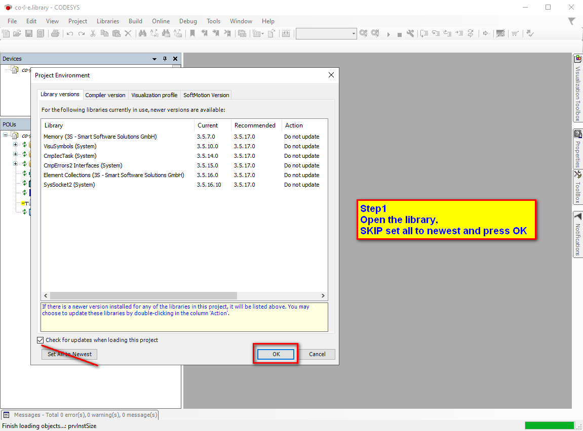

Step1
Open the co⚡e.library, Be sure to skip the "Set All To Newest" and press OK

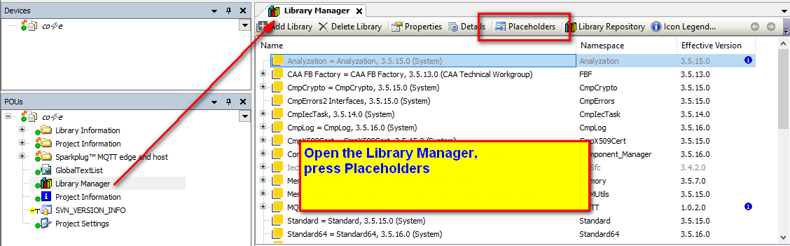

Step3
Some tips on resolving Errors

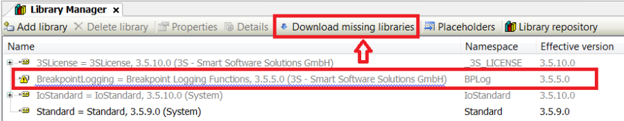

Download any unresolved (missing) libraries
Open the library manager and if the button is shown, press it.
The IDE will automagically download all missing libraries and install them in your library repository.
Set correct placeholders
Sometimes it could happen that some libraries are referenced that are not installed and/or not downloaded. In this case you can "force" a library reference.
Select the library reference that you want to force and select the version you wish to use from the pull-down menu.
